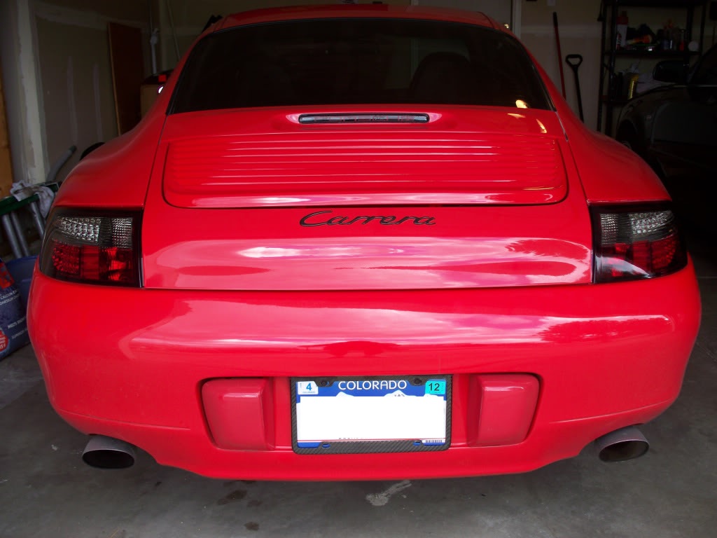

These are my tinted ones I got from Redline I think on Amazon. Have been working perfect ever since. They did have extra connections I did not use due to possible fuse issues. Can't remember the connections though. Mine are smoke.
