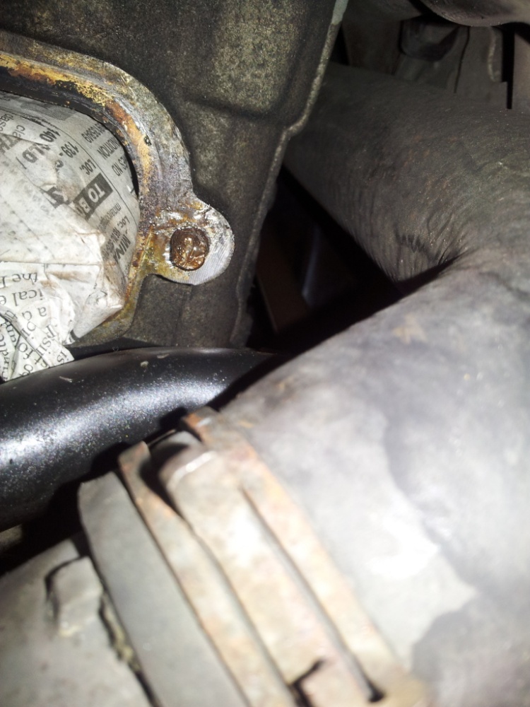

2. Can't get these studs out! Tried grinding, drilling, hammering them but the bolt rust ate into the pipe already like they are welded to eachother and dam the steel is so tough that I already destroyed a dremmel and 2 drill bits
I have 6 of these to deal with
The car is in my home garage and I'm about to have it towed to the pro muffler shop so that they could torch (acetylin) the bolts out.
Any of you guys experienced the same problem with super rusted bolts? How'd you get them out? TIA!

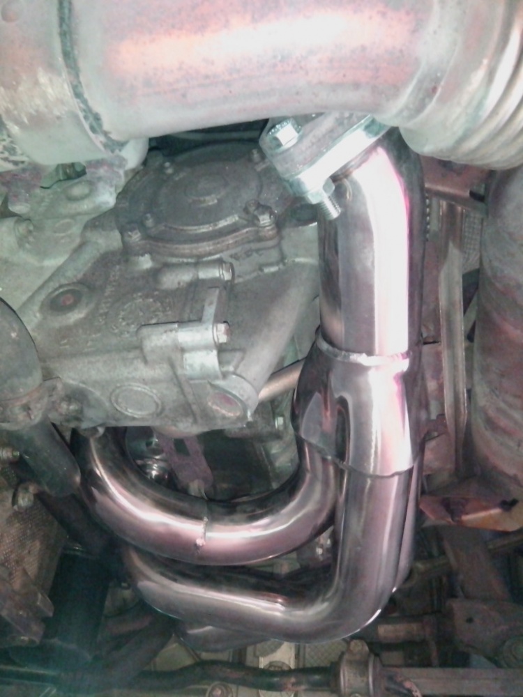

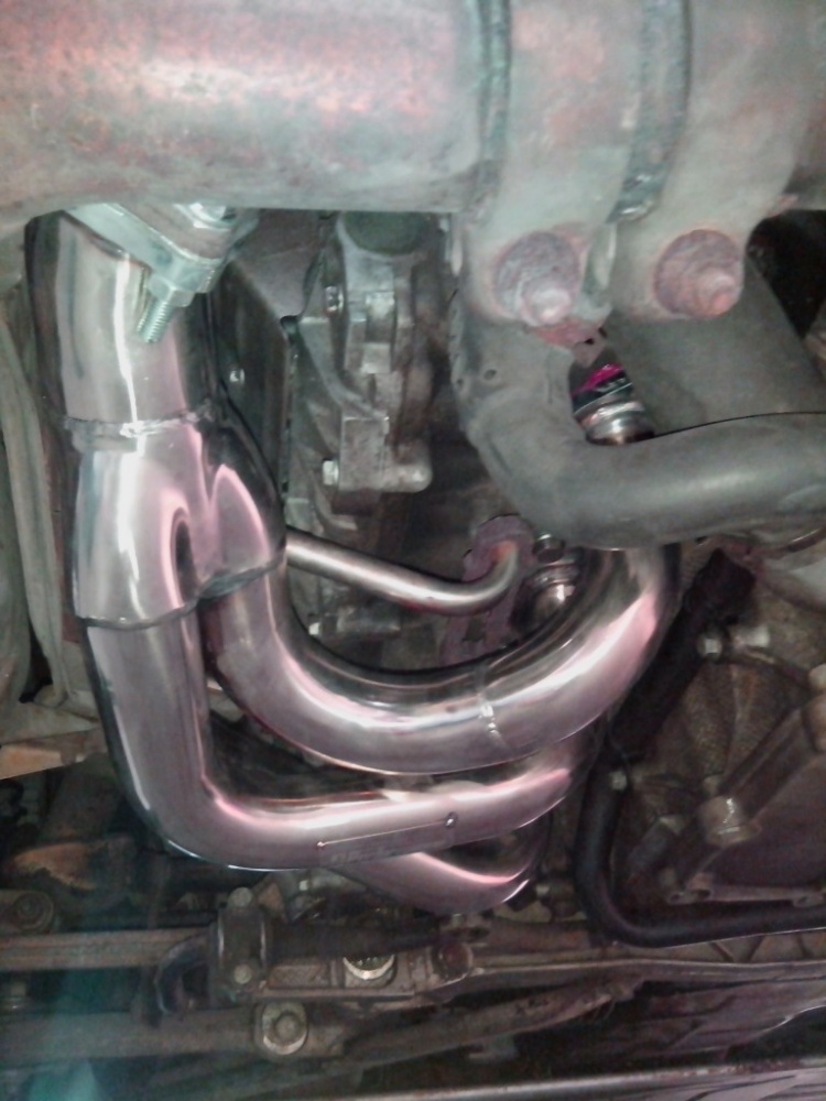

Just an update on this project.
For the total of 6 studs that wouldn’t come off shown on my 3rd picture, I drilled them out using, carbide drill bits and a round file I modified and cut so that it becomes a file type drill bit. I then continued filing them out until what remained fell off.
On the broken exhaust manifold studs - What I decided on first was do the screw extractor route. Unfortunately the screw extractors broke and got stuck in the broken bolt so yes – I had to re-drill them out using Dremmel with a carbide cutting tip. I was able to make a hole in the center of the broken studs but I didn’t really want to continue in making the holes wider for fear of destroying the threads on the block.
What I finally decided on after this 2 month project (I only work on it during weekends) is to let go of these 2 bolts (1 bolt on the right header and 1 on the left header). Use a lot of gasket and tighten the other 5 bolts 10% more than Porsche specified torque per bolt (e.g. 20ft/lbs instead of just 18 ft/lbs.). I also wanted to shortcut the process so that I will finally know if the headers will even fit. Fortunately, the headers where a perfect fit. At least that was the only nice thing about all the trouble – they fit perfectly! Fortunately as well, No exhaust leaks! At least, not just yet probably – or I might be just lucky.
Anyway, in the future, if the headers leaks or I decide on doing some other things under there which requires time, I might just consider using Time Serts as suggested by pmkazz. Tried doing some research on the topic “missing one bolt on exhaust headers” and it shows a 50/50 chance of being a problem or NOT. For some 5 studs are ok to keep the header in place for some it’s not. For now, since I don’t have that much choice, I’m good and hoping the install will hold…for the meantime.
Here are some pix of my install…
Again, thanks for all the inputs guys!
