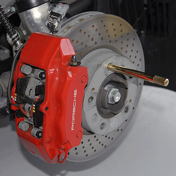

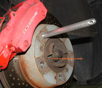

Porsche OEM Wheel Hanger ($9.95):
Booth Design Wheel Hanger ($29):

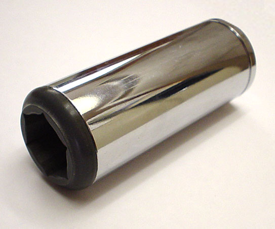

Soft Socket from Boothe ($29):

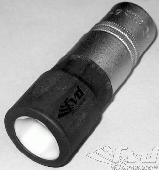

Soft Socket from FVD with Rubber outside ($62):

The wheel guides are a good idea, but if you take your time it is not hard to set the wheel on the hub, as for the soft sockets, just wrap a regular socket with some electrical tape and you just made your own scratch resistant socket!

The electrical tape way works well. You can also do the security socket. I have tape on the inside and outside of mine to help stop scratching. Also note for the 996 the coating on the bolts will let go at some point and you will end up painting them. Make sure you use a 6 point socket. NEVER use a 12 point socket.

the OEM wheel hanger should be in included your spare tire tool kit if you still have it
