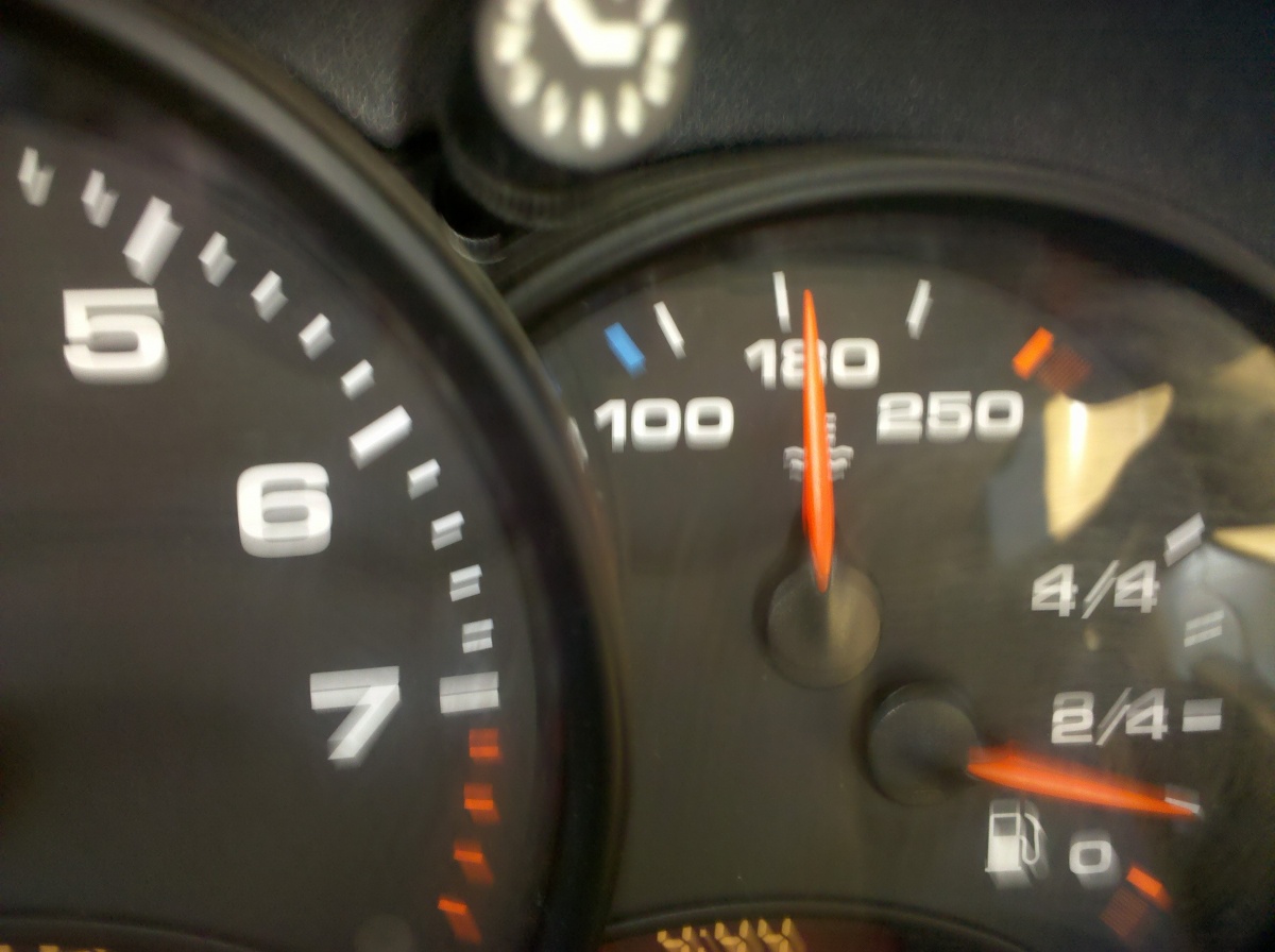

A few days ago I added the center radiator "upgrade" to my '99 C2 and it was definitely well worth it.
The car is running noticeably cooler, here's a pic after driving for about a half hour after dropping my daughter off at the airport.
the needle used to sit part way into the 0 and around town on warm days it would creep up to just past the 0.

Old Mar 29, 2013 | 11:35 PM

Good info, where did u buy the "kit" or did u piece it? Is it a bolt on upgrade or modification needed for a 996 oem bumper
