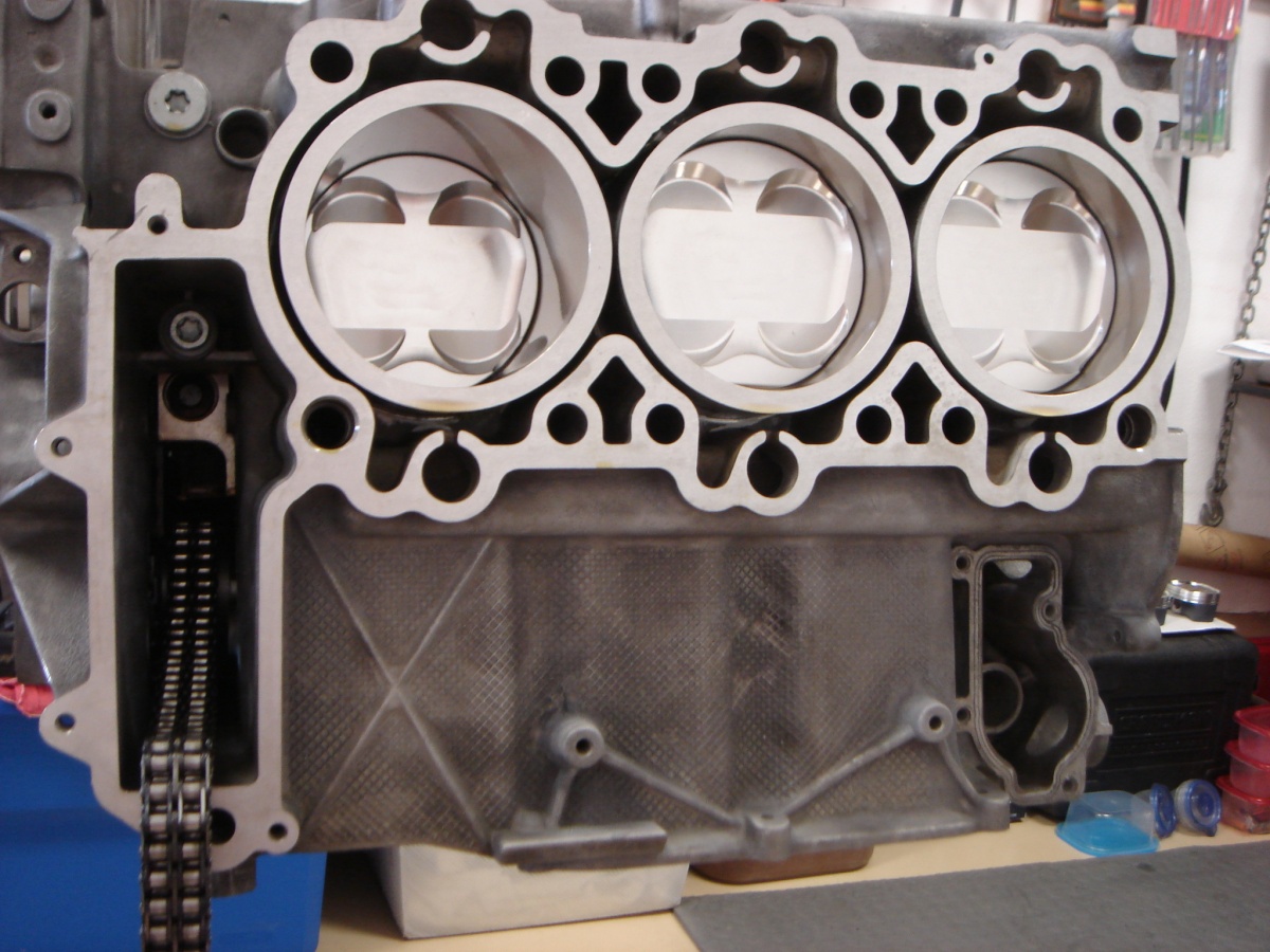

996 3.4 engine has the weakest cylinder walls of any watercooled flat 6 cyl.
So 1st step should be to sleeve block with bigger, thicker cyl sleeves to add 3mm to the bore & give you 3.6Litres.
This will add power,reliability,resale value & requires no "tuning". For more info see this thread: https://www.6speedonline.com/forums/...gine-sale.html
