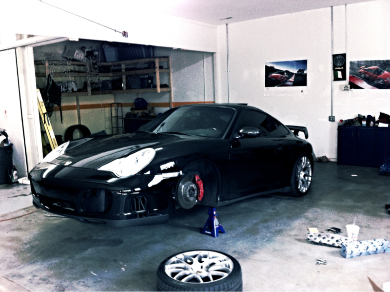

I ordered the seals for the diff part# 999.113.454.40. I second day aired them in order to get them for this weekend and I will replace them and be all set.
In the meantime here is how she will sit
