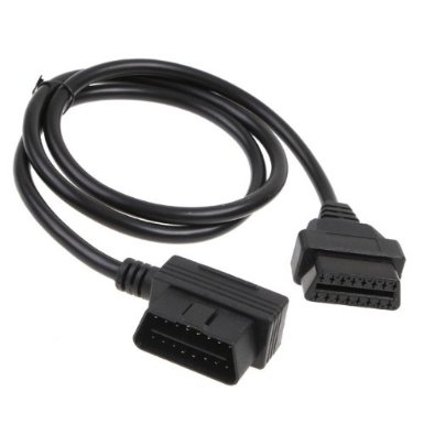

A bigger issue is the angle of the OBD2 port on our cars... It points straight down int he drivers wheel well, so a big bluetooth module would kind of be in the way.
I purchased an OBD2 cable extender with a right angle at the mail end, and ran it to behind my lower console where the bluetooth module plugs in.
Much cleaner that way, and if I want to disconnect it, I just pull the right angle connector out from beneath the dash and tuck it back up behind the port.
