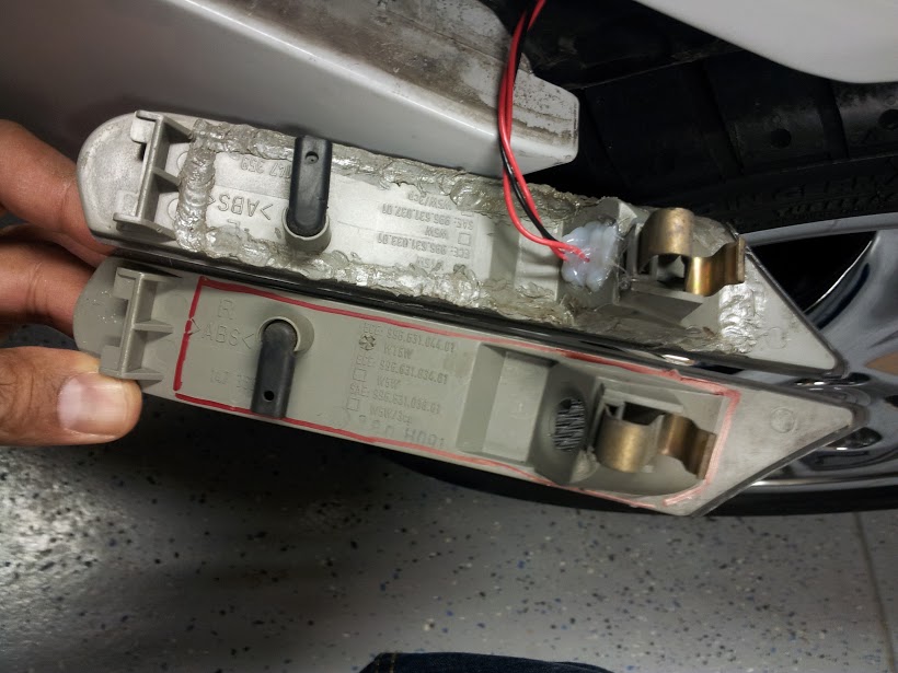

Converted mine to combo day time running lights and signals

Here the link to the DRL with module.
The trick is to get the lens off the headlight tried every scenario from heat gun ,baking to VooDoo.
ended up with a soldering gun
The instructions are on their youtube site. wiring is easy. I hated to hack up the headlights this way but turned out okay, and didn't like the yellow reflector from behind the lens.
I went with the Depo light in the rear.
http://www.exledusa.com/exled-sf-block-premium-universal-eyeline.html
