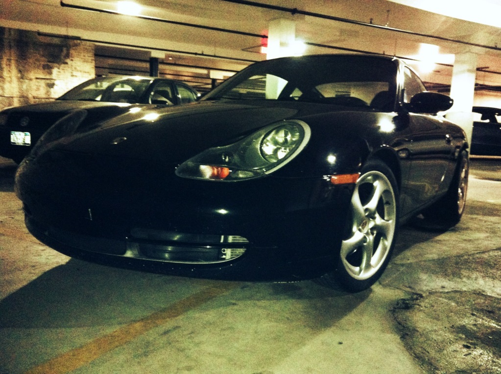

what options do I have? like maybe clear only, no yellow. what say you?

I believe that the mkI (like the pic you're showing) all came with the yellow turn signal. Along with the different headlight shape, the mkII headlights have clear turn signals.
You *can* change the mkI headlights to a clear version - but be prepared for sticker shock as each light is almost $700 from Pelican Parts (for a grand total of $1,400 pus shipping and applicable taxes).
There is also a mod to remove the yellow from the mkI headlight - which is free, but does require performing a degree of surgery on your lights.
https://www.6speedonline.com/forums/...ring-lens.html

Looks like a 99. You've got the permanent yellow's.
You can 1. tint the amber portion 2. Buy new clear halogen headlights 3. Buy new litronics 4. Buy aftermarket.

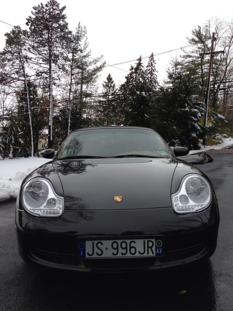

I went aftermarket with the LED lights. Got them online for $850-900. I think they update the car a lot.

Looks great... where you got them from? any complains with fitment? did the come with xenons? thanks!

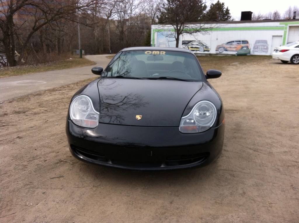

Originally Posted by white out
there is this OEM version too
What OEM headlights are these? Since I'm taking my 996 off the market, this is the headlight I've been looking for but unable to find. Will these plug and play in my '99?
I got them off ebay. The fit is pretty good,just like the LED tail lights. They did not come with Xenon lights,but i added them to the headlight and foglights. I'm very happy with them.

Thanks for the info, they look really cool! was installation of the xenon difficult? where did you place the ballasts?
