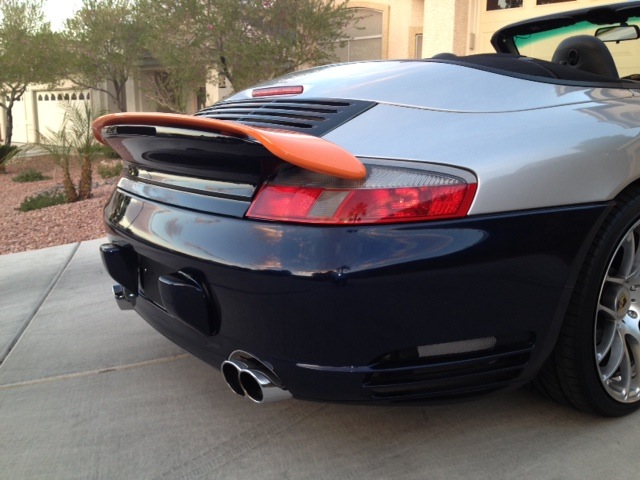

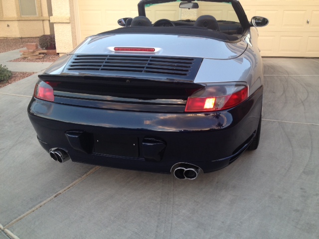

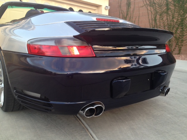

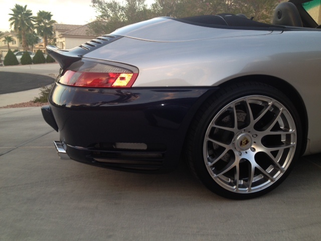

Requires cutting 2+" from bottom, 1/8"+ from both sides, & <1/8" from top edge for the cabriolet. Latch must be reattached (glued/glassed/etc)as well. Hinges require a little modification and adjustments. Hydraulics will not fit without making room in the engine compartment.
I am in the process of modifying this turbo deck lid(cut a little long for finish and fitment) on this 04 996 C2 NB Cab. Also pictured is an OEM 996 Turbo rear bumper (not yet modified in the wheel well area), C4 exhaust pipe extensions and tips.
The orange wing is an OEM 997 (not in place yet). Going to fab stainless tube and mounting plates for a fixed wing.

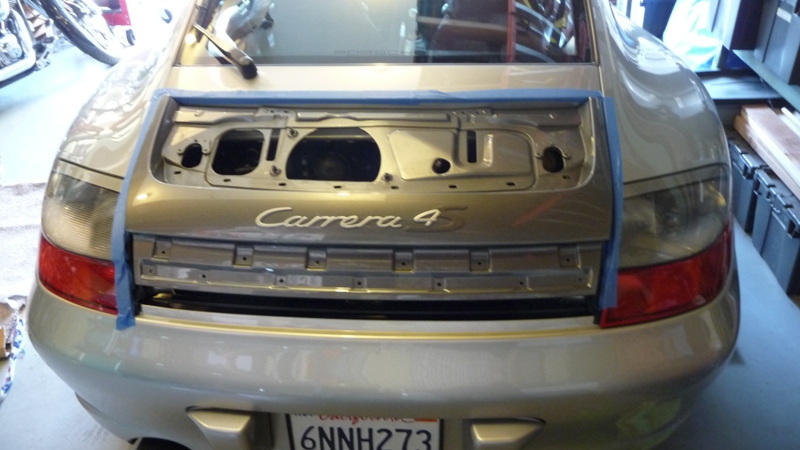

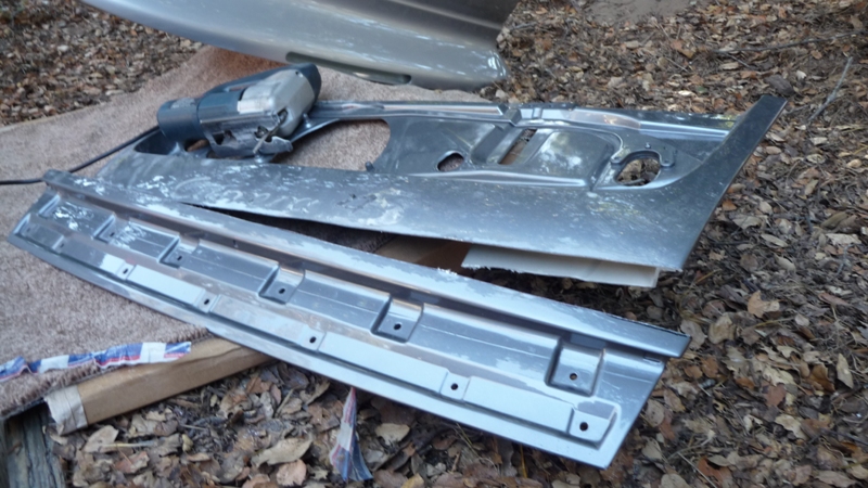

I suppose one could replace the panel but it would require way too much money and effort with negative results IMO. The panel is not a bolted on piece and is an integral part of the body structure. In my estimate it would require removal of the rear window, engine, tranny and local interior and engine compartment components to gain access for cutting and welding. Afterward the structural integrity would be in question and the resale value of the car would be greatly diminished as well as reducing the potential buyer pool. In my estimate this would be a $5-6k job unless you are a very skilled body person yourself.

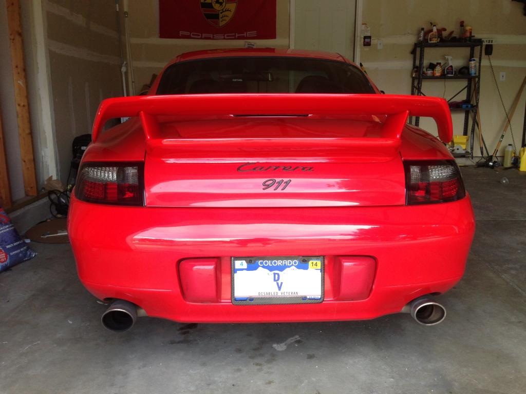

You could do what Holdem has done but it just doesn’t look proper or correct. The lower lid indentation line doesn’t match up with the brake light lens as it should and the spoiler section sits far too low. It looks like a disjointed misfit. At least it is easily reversible by removal and reinstalling the original lid. Sorry Holdem, I mean no disrespect and just giving my honest opinion. It does look like your craftsmanship is excellent.
I started a project to fit the C4S lower center reflector section to a Turbo lid. I stalled because I need to find a donor lens itself. One that is broken or cracked so I can use it for fitting while doing the fiberglass work and not worry about buggering it up. Anyone got one? Alas, I just found an oem GT2 decklid so now I’m going in that direction. I still might do the project just for fun unless someone wants the turbo decklid.

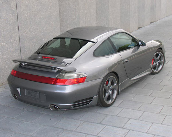

I think the C4S with its oem decklid is the best looking 996 body bar none. If I had one or was able to fit the lid to the Turbo I would go with the Techart Type II wing. That is what I was going with if I finished my project. I think it looks perfect for the C4S. Yes it is pricey but once you consider all the work and cost of trying to fit a Turbo lid it starts to look pretty good. Plus it is reversible and can be resold.
I attached pics of the fitment mismatch of the C4S vs. Turbo lid; my project start; and Techart Type II wing.
