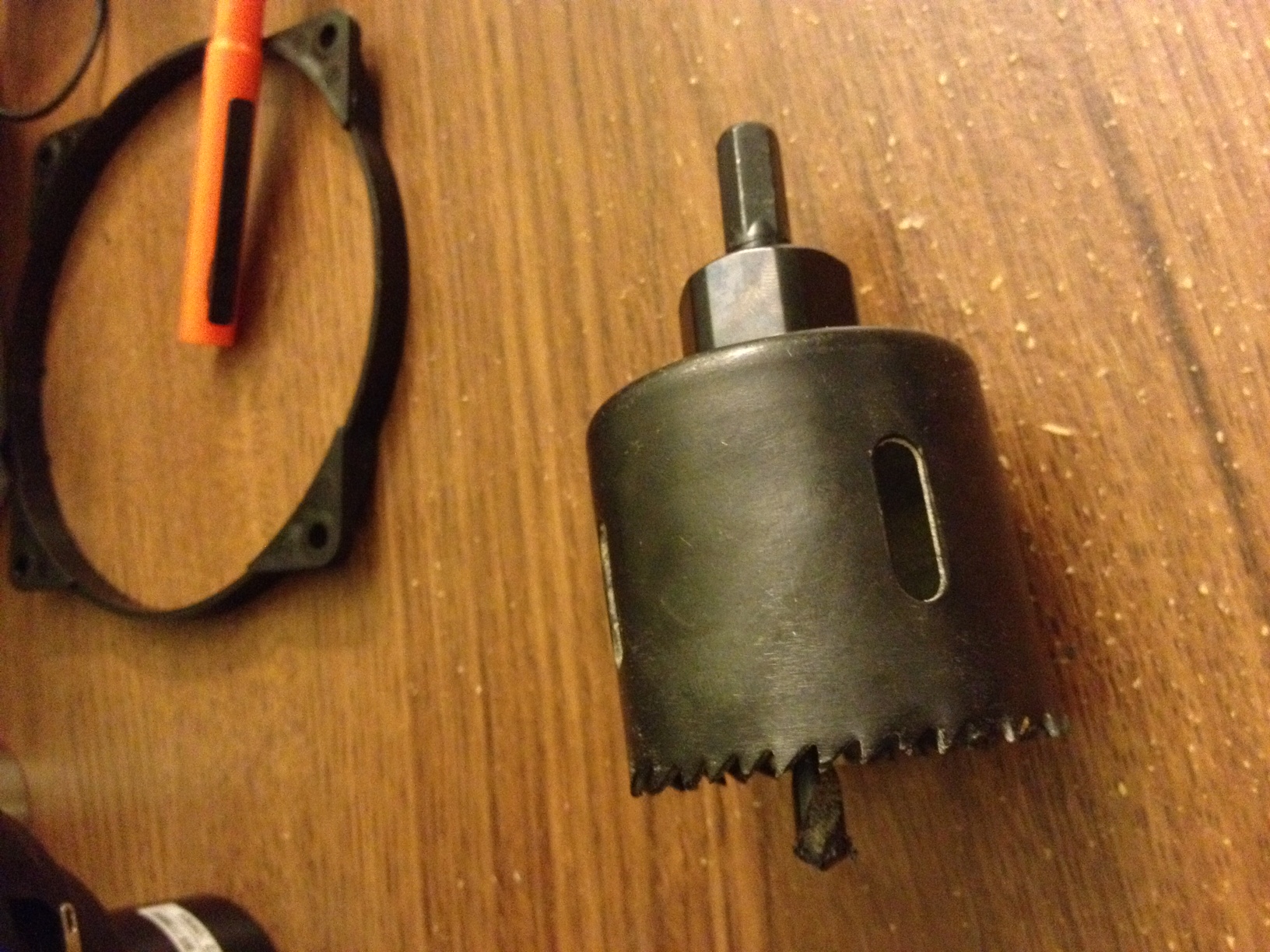

2. Pick up a 2-1/3" ( 54mm ) hole saw attachment at your local home depot. I had one lying around from when I installed a door lock set.

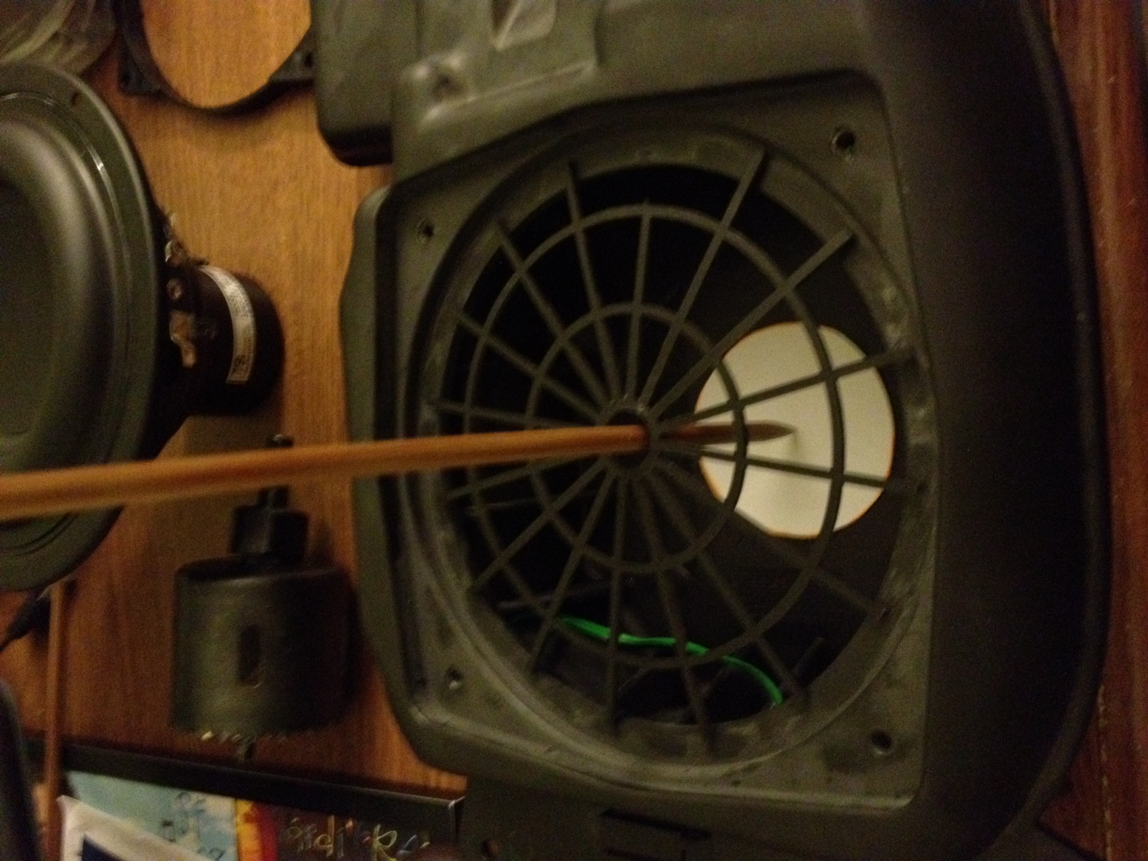

4. Use speaker cover as a guide to mark the center point. I poked a little hole through the back of the enclosure with a punch to use as a guide for the hole saw. Drill out the 54mm hole.

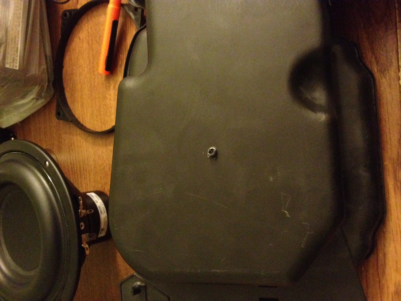

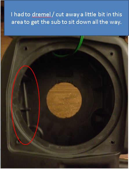

5. Cut / dremel away at the inside of the enclosure until the sub sits down in there. Check the picture for the part I had to dremel away.

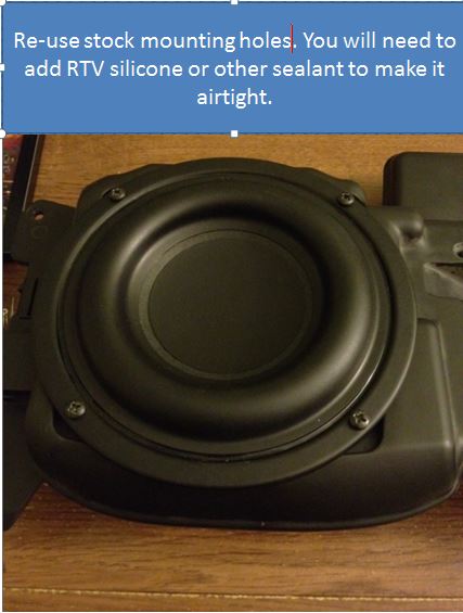

6. Mount the Tang Band sub using the stock mounting holes, they line up perfectly. You can reuse the stock spade connectors, if they don't fit perfect you can give a little squeeze with pliers, but don't overdo it. The positive and negative are different sizes, so it is easy to figure out which is which.

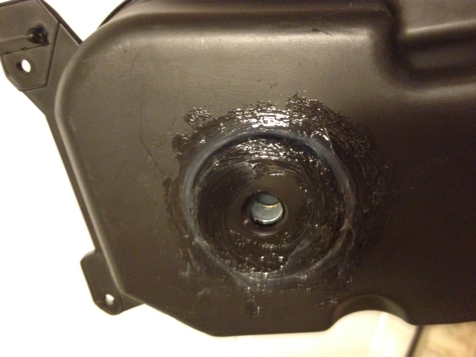

7. Use RTV silicone or some other sealant to make everything airtight, front and back. This is important. My job was not the cleanest, but it works. Black RTV silicone would work well and match the enclosure. The sub pole vent (hole in sub magnet) vents outside the enclosure. I looked online and some people said that is ok. Don't seal that hole in the sub magnet, the coil needs the ventilation.

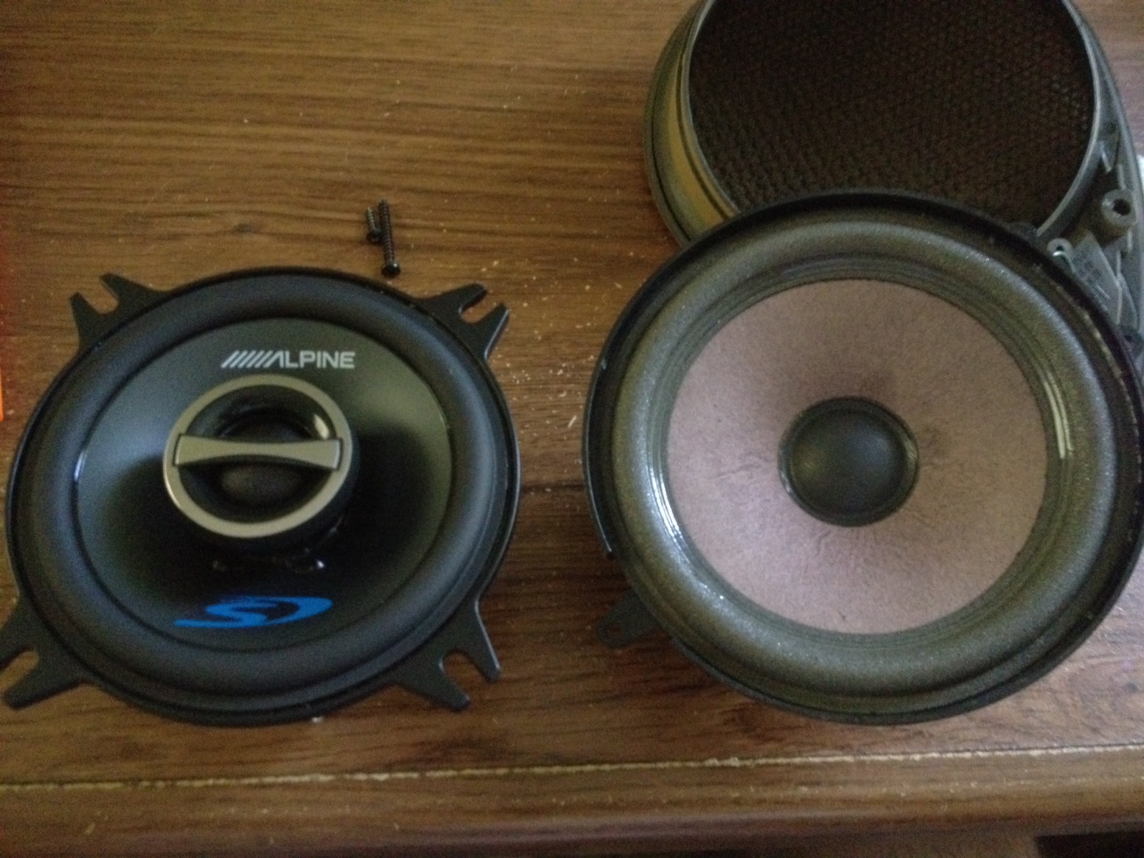

This is covered pretty well on other threads / youtube. Some additional pointers. I used Alpine SPS 410 speakers, about $80 for 4.

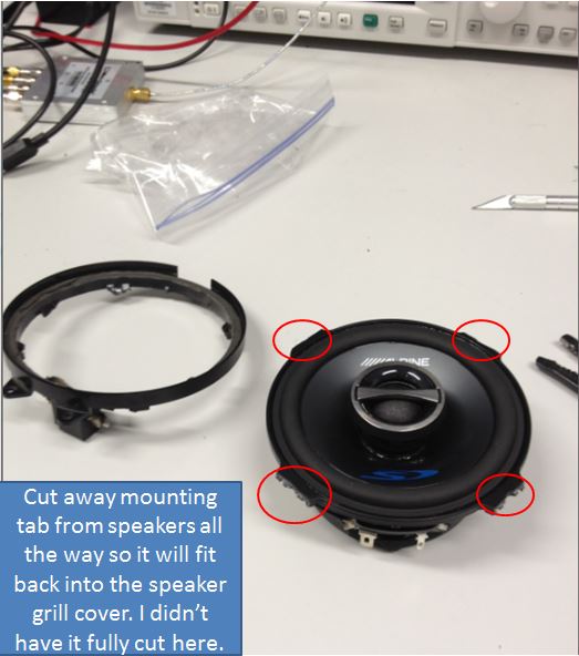

1. Have a good pair of cutters handy to cut the old speaker basket support. I tried a dremel but it was too messy. A pair of dikes works much better. You will need a dremel to get the old electrical connector off though. What I did was solder the old connector to the new speaker with a little slack so that it would be easy to plug and play.

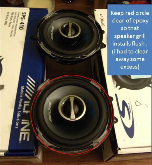

2. When installing the new speakers into the OEM mount using JB Weld or some other epoxy, make sure to leave space for the rim on the speaker cover. Look at the red circle in the picture. Make sure that no epoxy seeps into that zone, otherwise the speaker cover will not sit flush.
