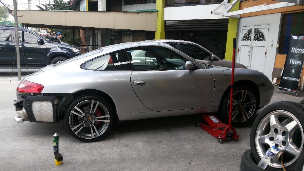

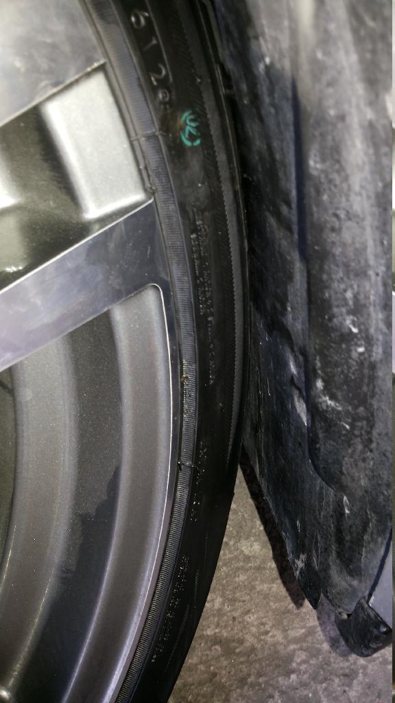

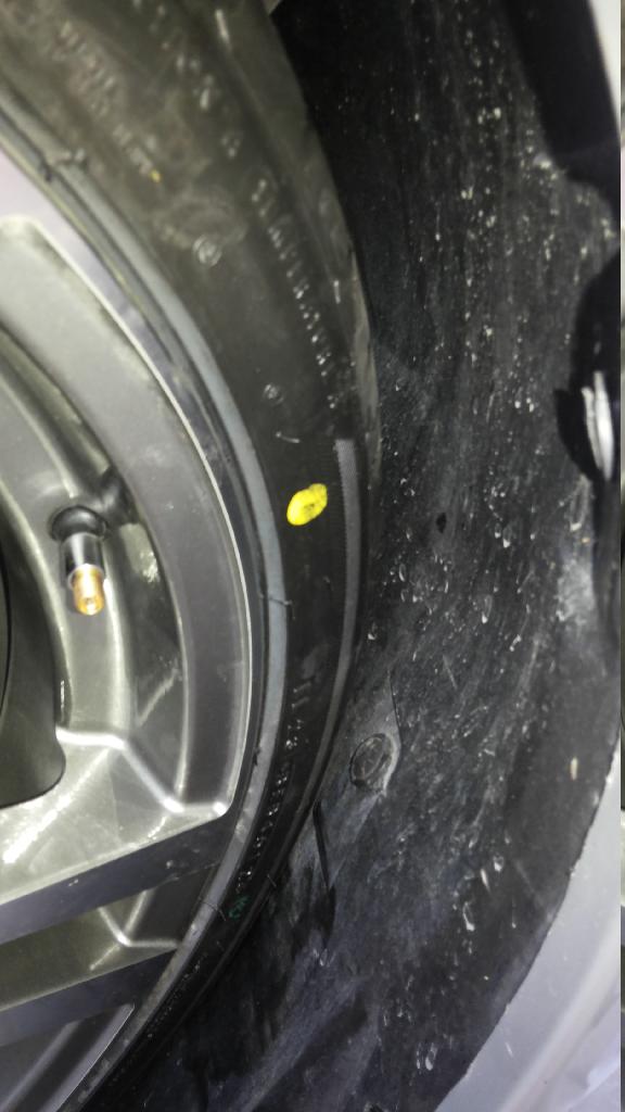

I tried to fit 19"s
So contrary to all the suggestions and advises of the nice people here but for the sake of experimentation :-) I tried to fit 19" rims on my c2 NB.
Front rims 19" x 8.5"
tires 245 x 35
With 3mm spacer
Rear rims 19" × 9.5"
Tires 275 x 30
With no spacers & fender roll up
Guess what? The rear rims didn't rub at all and looked really cool! Unfortunately, the right front tire is rubbing on the fender liner :-( strange that the left tire is not (close but not rubbing). Is this a camber issue? Is there a solution to this? Do I take out the fender liner? Any suggestions? I really like the rims. They made my 99 pcar looked really updated hence my persistence. I'm sure many will say go with the 18"s instead. If I really wanted to force these 19's, what can I do?

you can push the fender liner in a little. the metal bracket that holds it in place will bend slightly. if it is a slight rub. if one side clears the liner then the other side should also .

thanks for the response. Just a follow on question; I'm assuming you have done this mod - Wouldn't bending any metal bracket at the back of the liner affect the radiator scoop or fan? I'm worried I'll damage delicate components at the back affecting the cooling system.

Or you can try a heat gun and massaging the plastic in a little in that specific area. Pro's do it all the time on show cars.

Thanks. Yeah the tire shop recommended I do that as well. I'll also try to take out the whole fender liner and see exactly what I'm dealing with. I'll post some pix of what it looks like in there. Or maybe I cam initially search for existing pix...

nothing to worry about , you will only get a slight adjustment out of it. did this on my boxster when i installed 19" .

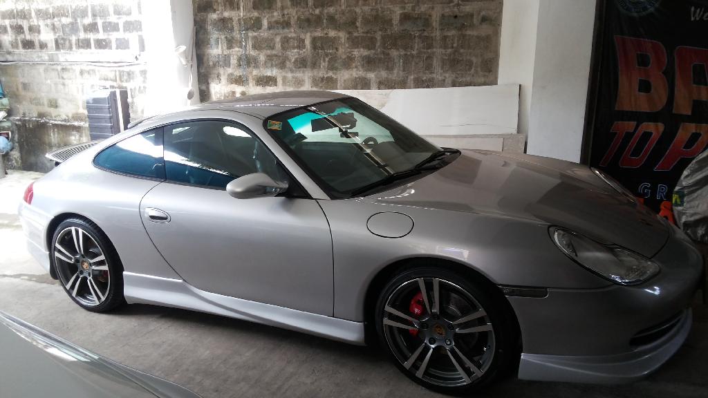

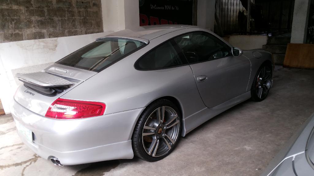

Finally!
Just to update the thread - finally I successfully mounted my 19's on my 99 C2 Narrow body. The front right tire now fits after doing 3 things: changing the tire size, installinh 3mm spacers and replacing a fastening clip on my fender liner :-)
Front tire size is now 235 x 19 x 35 (instead of 245)
Rear tires remained 275 x 19 x 30
Just sharing the picture of the project car with you guys...

Looks good. What front lip and rear valence is that? Any other shots?

I got a local fiberglass shop make a replica of a certain 911 kit (not sure maybe GT2?) with slight modifications. I haven't got the rear wing fitted yet though. Here's another shot. Sorry its dark in my garage but it's a good view of the front lip...
