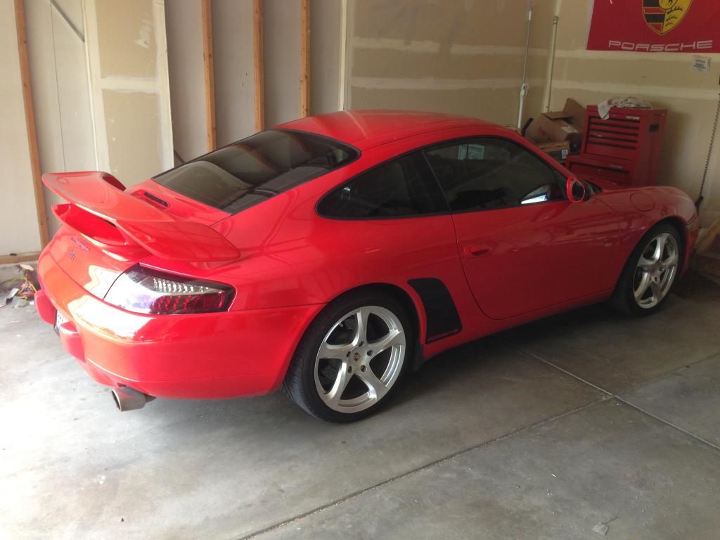

Regardless of the rim style, stick with 18 inch rims. Tires are cheaper and more available. Just my opinion. I got a decent set of rims off TireRack. Kinda a modern look of the turbo rims and perfect fit. Again....rims and tires are a personal choice....out here with 19" rims....I would have serious issues on the Colorado roads. Also, you have to look at weight and performance things. Too many variables to talk about here. But...this is classic and what I went with.

@carcster88 - thanks for this photo. car looks great. i like the look. what are the rim specs and tire specs if you don't mind? rim offset front and rear, series, tire thickness etc.

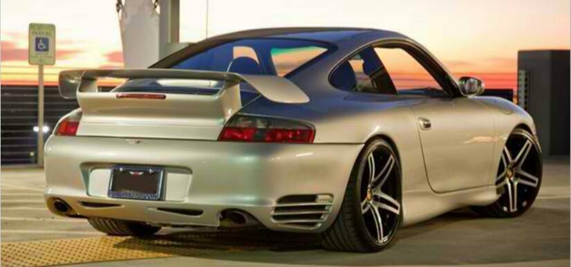

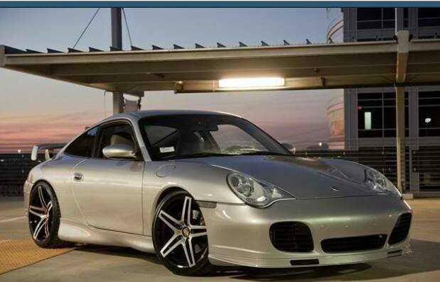

Searching around fond this look that I kinda like. Is it as simple as installing the rims and tires to achieve this EXACT look or are there other steps to take e.g. lowering springs, change shock absorbers, spacers etc?
