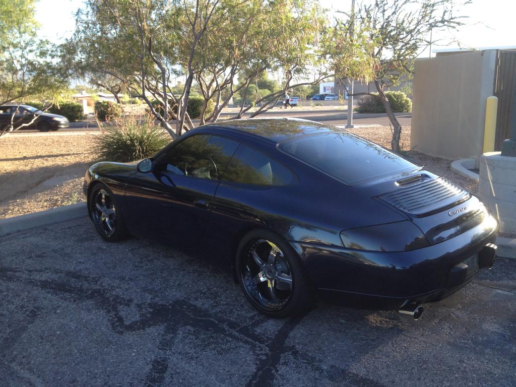

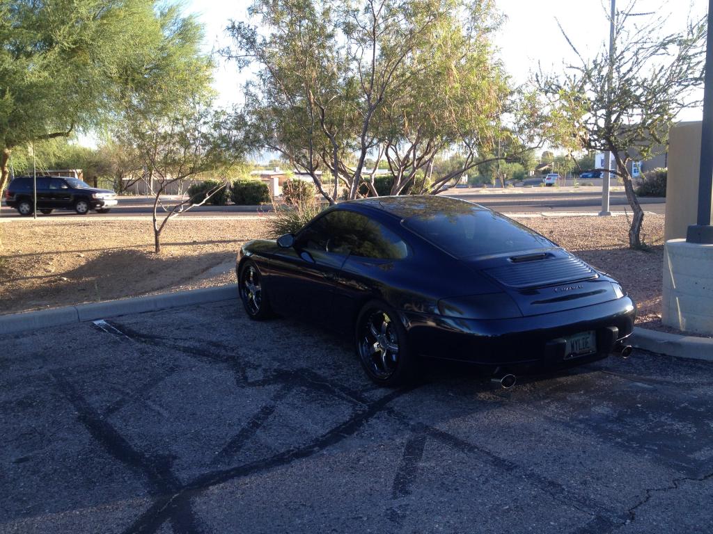

I have 9/11" wheels and springs lowered 1.25 inches. No rear tire rub with 275 30's on the rear and 235 35's on the front. I did have a tiny rub twice during a u-turn on a downslope in the same place in town on the fronts, but very little. I love them. The car is a 99 C2, Not my 996TT pictured.
ID:	324122   Click image for larger version
