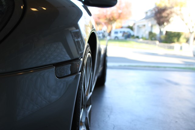

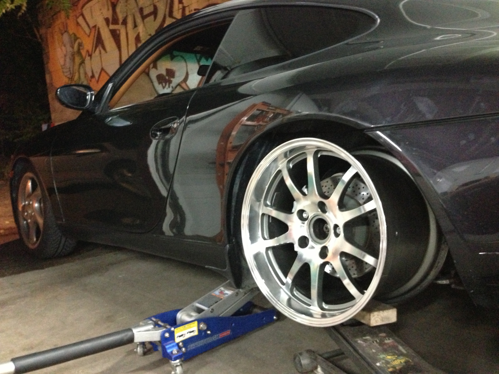

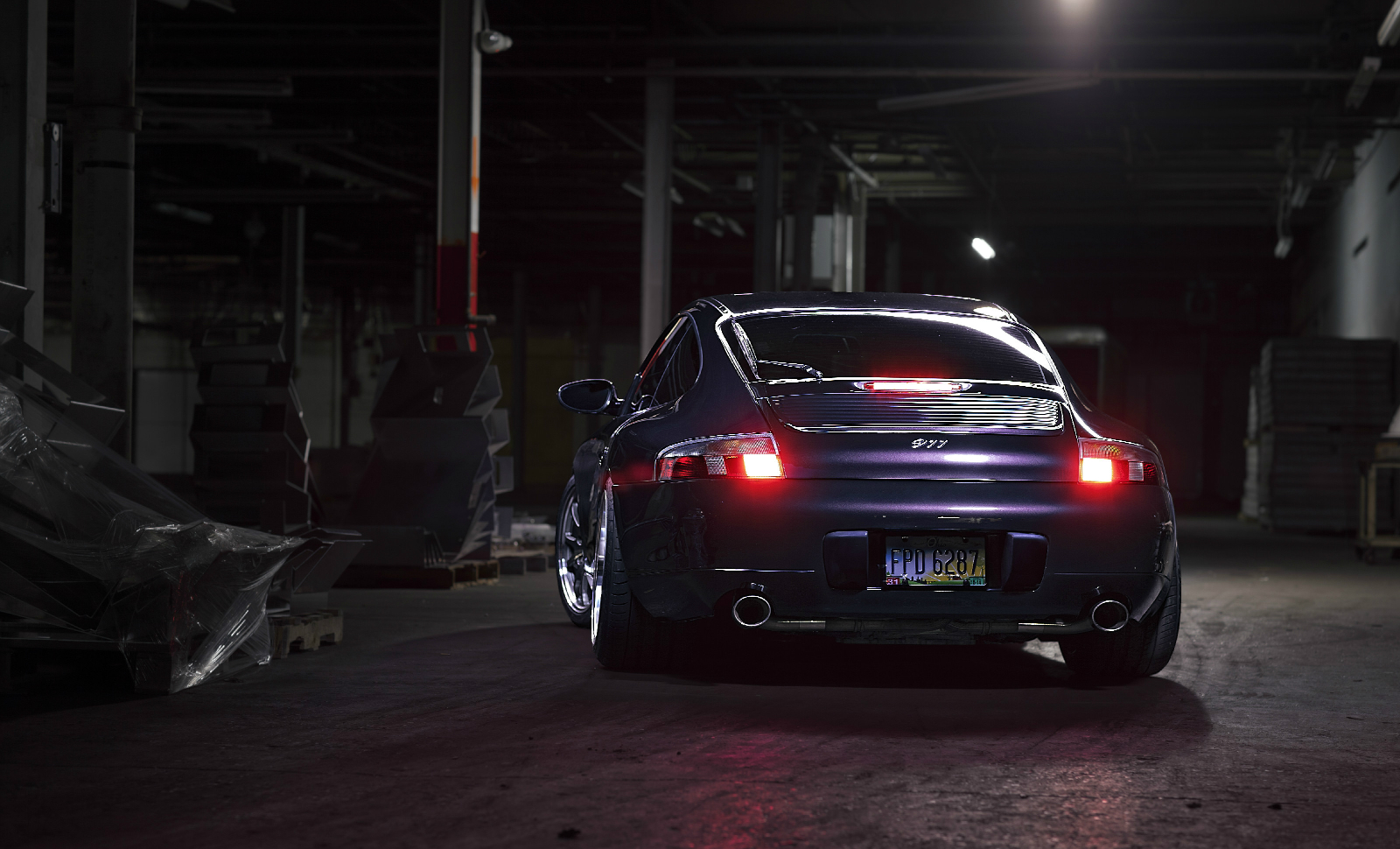

18x11 +38ish. Im lowered A LOT... -2.4 neg camber
Looks great! I'd like to know more about your setup:
How much is it lowered? (On springs or coils?)
Tire size?
Narrow or wide body?
Fenders rolled? Pulled?
Oh yeah, send more pics!!
Old Dec 5, 2013 | 06:13 AM
NineEreven's Avatar
Joined: May 2013
Posts: 271
From: Cincinnati, OH
NineEreven is a jewel in the roughNineEreven is a jewel in the roughNineEreven is a jewel in the rough
Tire size?

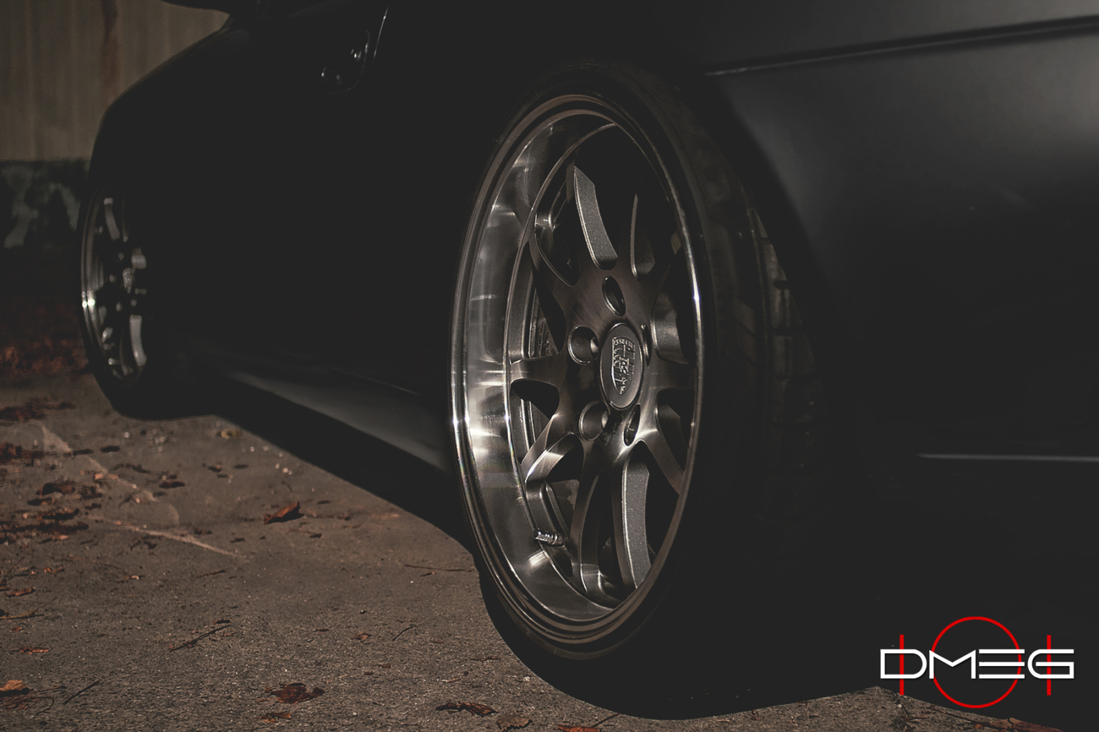

I didnt mesure exactly the drop but its probably 2.5 or more in the front and 2.25 in the rear.
I rubbed a bit on a 285 so im running a 275 on it with zero rubbing. Fenders are rolled but not pulled.
ID:	308226   Click image for larger version

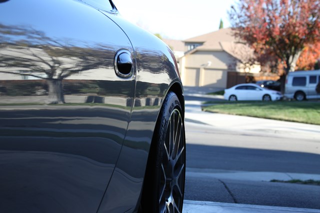

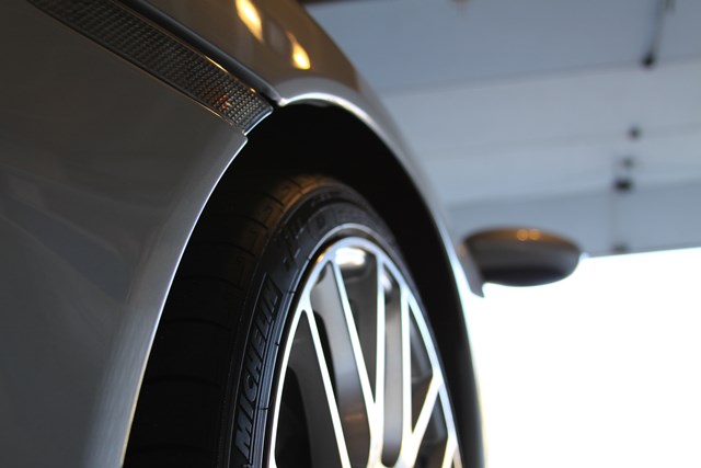

I'm running Victor Equipment 9x19 and 11x19 with 225/35x19 and 295/30x19 on my C2 but had to roll fenders. Hope these photos help.
ID:	308289   Click image for larger version
ID:	308290   Click image for larger version
ID:	308291   Click image for larger version
ID:	308292   Click image for larger version

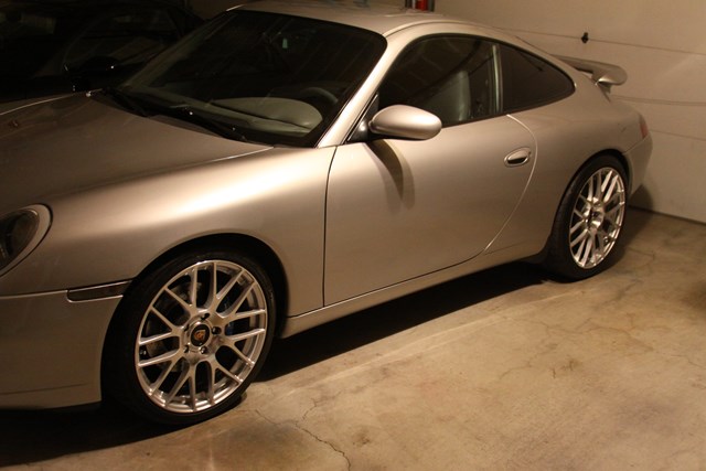

19's on NB

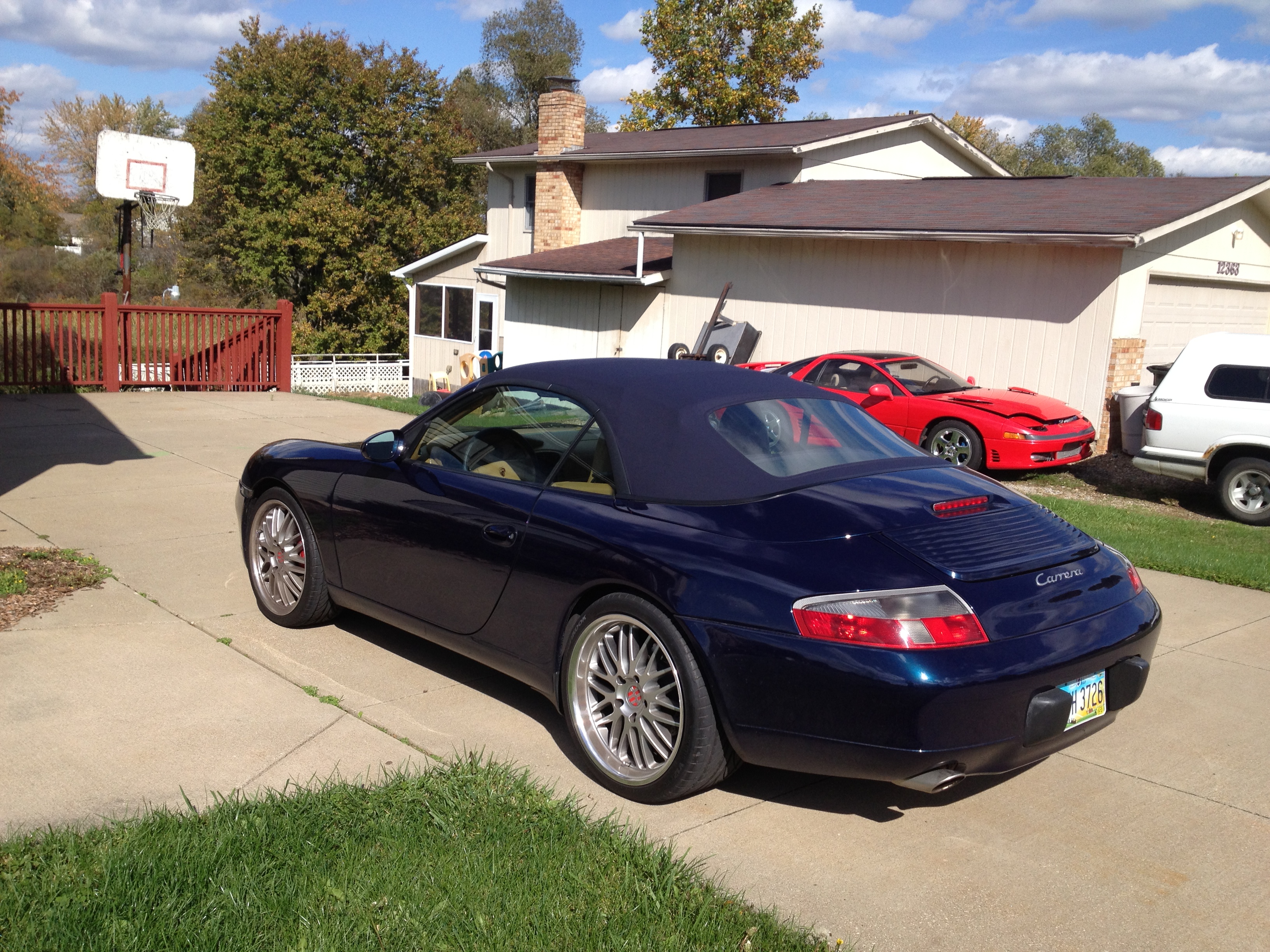

i have a 2000 NB with Victor Lemans 19's (295/30/ZR19 offset 52 rear, 235/35/zr19 offset 49 front) and hate them. the rears rub if you are not careful going over bumps, fronts rub on the plastic wheel well cover when you make a sharp turn. all of this was done by the previous owner including rolling the rear fenders. looking to replace them in the spring with 18's. if you want i can let you have them relatively cheap. wheels have no marks, rubs or curb rash.
ID:	308855   Click image for larger version
