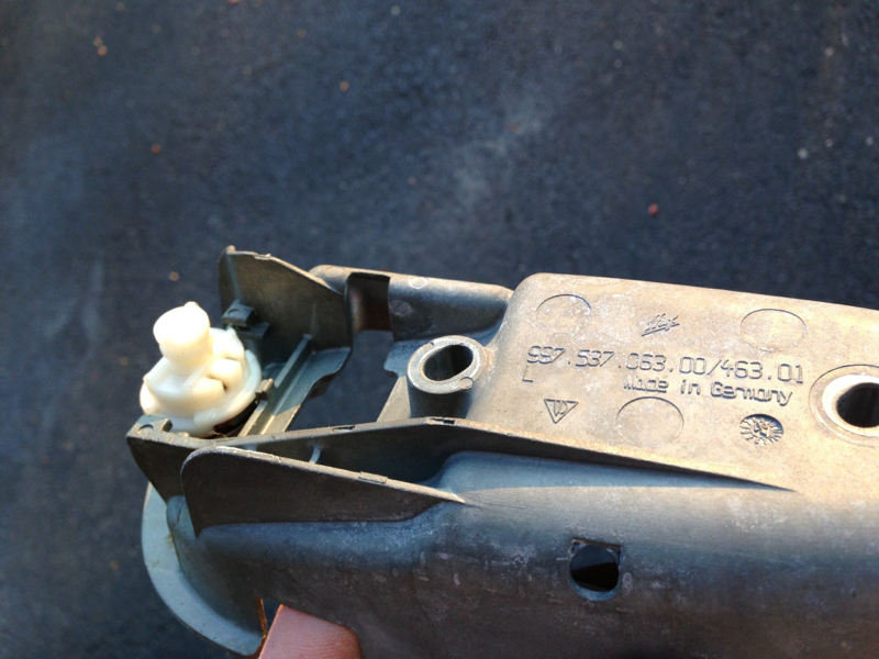

Well I was able to disassembled my driver side door and removed the door handle assembly. Discovered the connecting rod had sheared off...as this piece was made out of plastic unlike FMJ's which appears to be made put of metal. Will be paying a visit to my favorite P-dealer in the morning...cha-ching!
oh no! Sorry for that. Mine is a metal rod. Why did they even make a plastic version??? Tell us how much the thing is ok. Grrrr!

Dealer wants $450 not including taxes nor installation for the door lock unit but does include keying the lock. Will take 3 weeks to put in as a special order. The plastic connecting rod is not sold as a separate item. I will pass on taking this route. I have taken off the plastic connecting rod from the broken door handle unit so I know this part can be swapped out...will be keeping an eye out for unused matching part on eBay. Wish I had the metal connector rod.

Bought a used driver side door lock off of eBay for about $60 including shipping from a seller/parts dealer/shop in England. eBay sellers from US want between $200 - $275 for same item. The color of the door handle did not matter to me as I only need the plastic connecting rod. Should arrive in less than 2 weeks.
