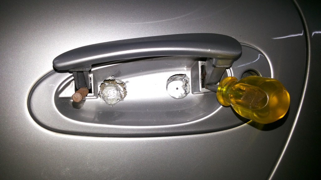

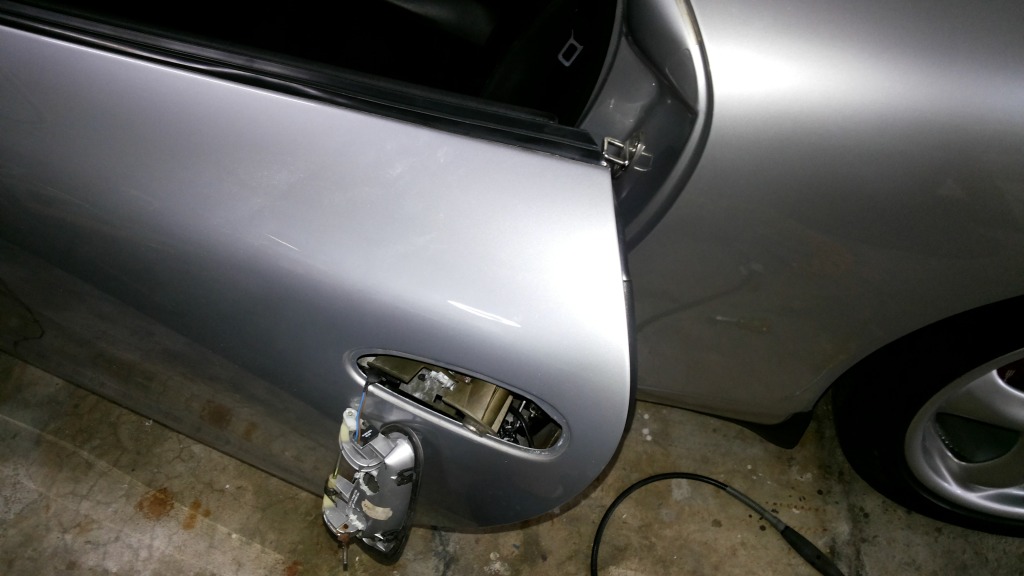

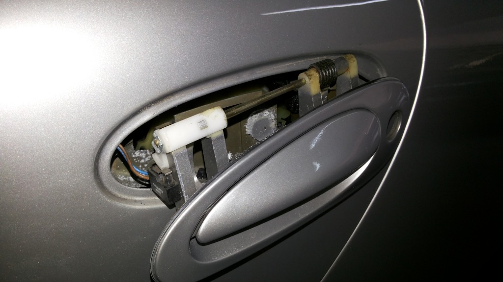

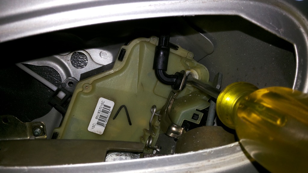

open sesame at last!
So here's how I did it guys. Believe me I tried everything including inserting a wire rod long enough to push the open button as well as hook and pop the inside door handle!
I ended up taking out the external plastic door handle using a dremmel cutting bit. I cut through the exact spots where the 2 securing bolts are and was able to pop out the handle in less than 5 minutes gaining access to the locking mechanism. Use a screw driver to rotate the locking mech and voila open sesame!
However, the sad part is I destroyed a perfectly working external door handle worth $25 bucks on ebay. Well honestly one of the reasons why I went this route is because I have spare door handle which I got off ebay a few months back when I thought the whole door handle was faulty where in fact it was only the microswitch :-)
Expensive lesson! :-( be sure that the rod connecting the key chamber to the locking mechanism is connected as well as the connecting plastic tube that opens the door.
I hope this will help fellow 911 owners in the future (not the carnappers and carjackers though)

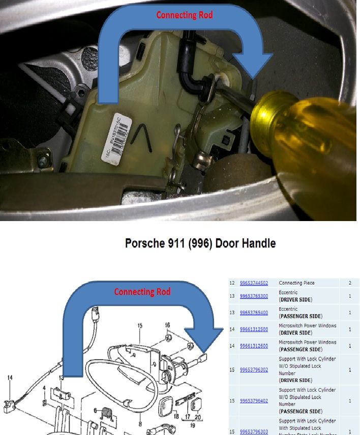

I bought my car 2 years ago and recently discovered that my driver door key hole fails to unlock as you have described....key spins around but never unlocks the door. What is the solution to this fix? Any help is very much appreciated. I am not locked out as my remote allows me entry. Thanks.

You have to fix it to avoid the same ordeal. Open the door side panel and peek whether the key chamber connecting rod is connected to the locking mechanism. Look towards the upper left hand side. Take a look at my 2nd to the last picture - the slot where I inserted the screwdriver is where the connecting rod from the key chamber should go in.
FMJ,
Is this what you are referring as indicated in the enclosed pix?
Thanks again.
Matt
