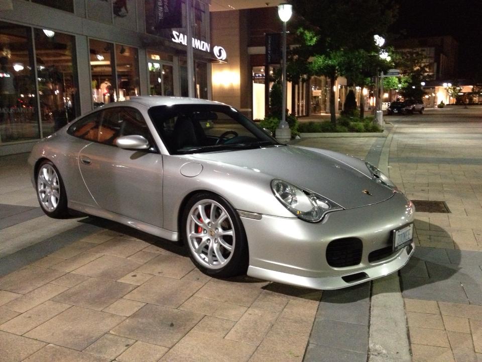

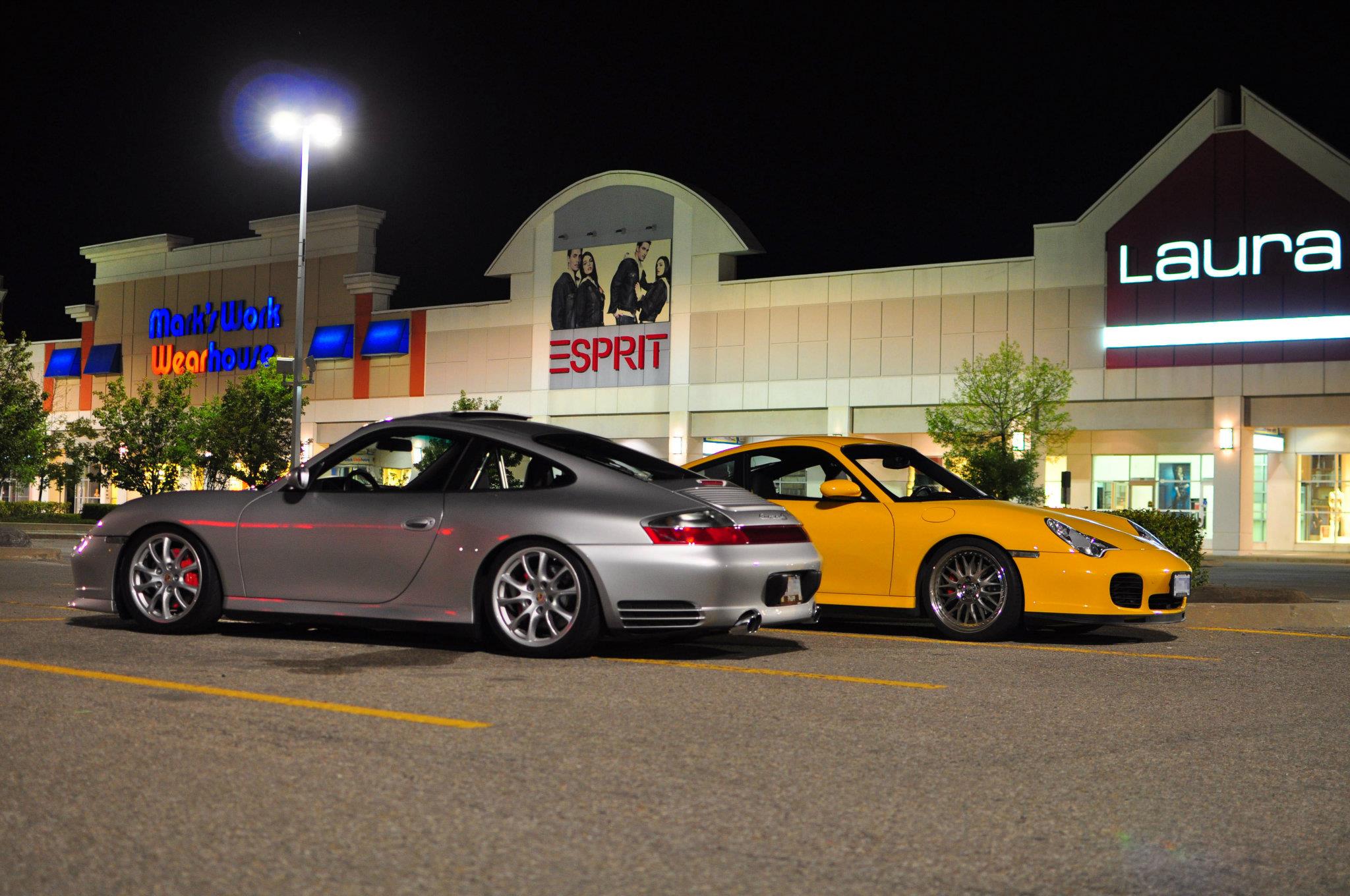

Originally Posted by Dennis C
Good catch. They were an option. The GT3 wheels look very good on the C4S.
Sure do, mine came with them

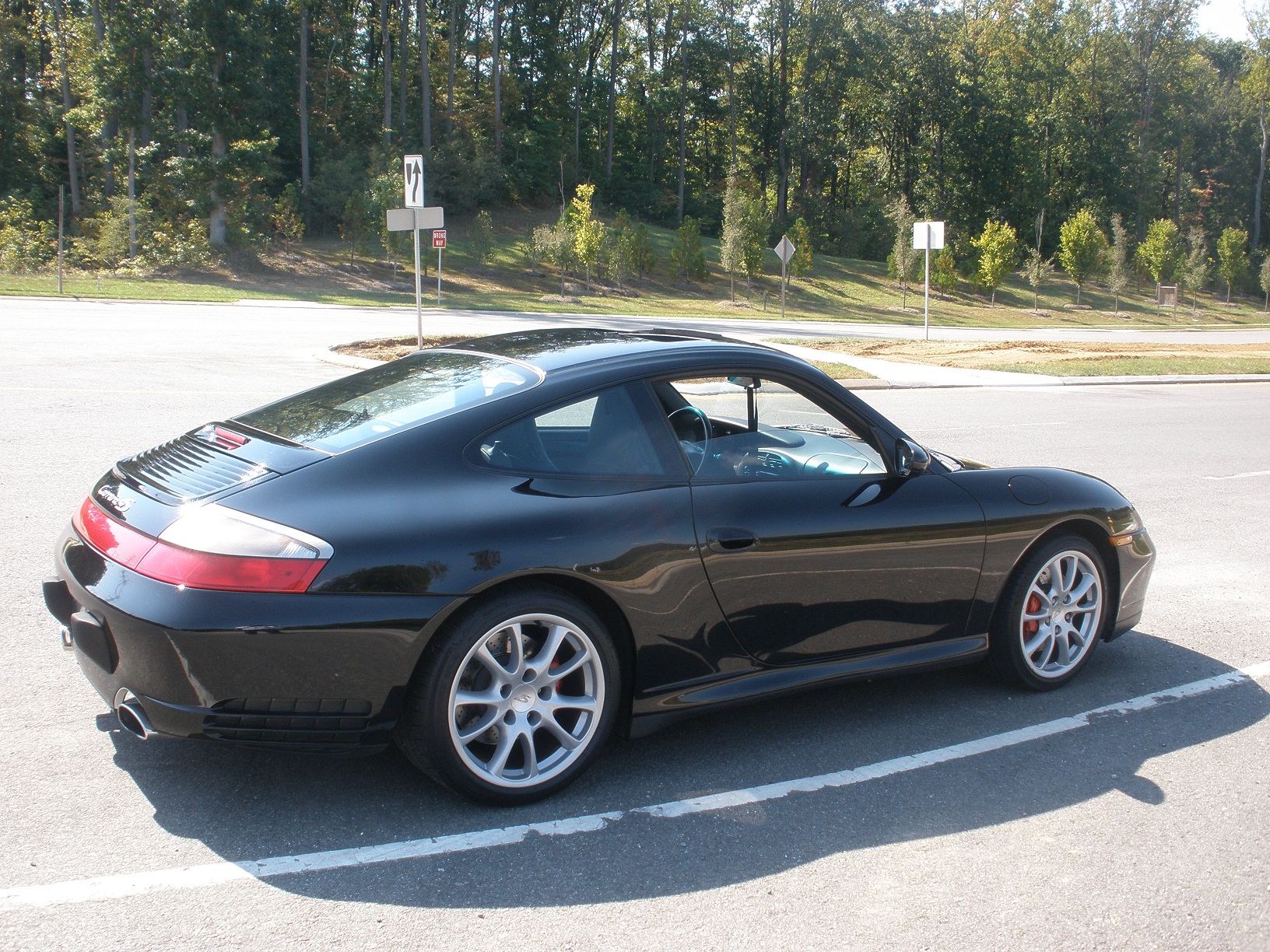

I have them and still think about switching back when I see pics of them. Go pick up a C4S. You will not be disappointed!
