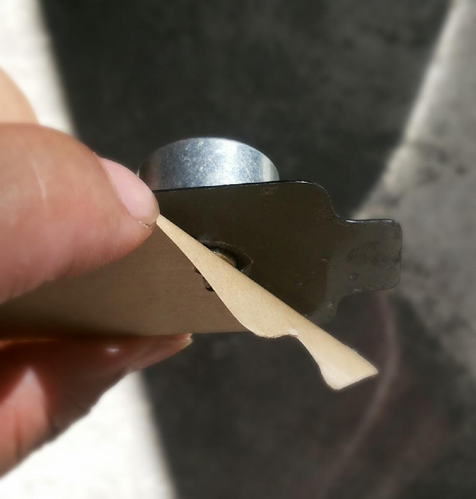

Thanks for this! Last question before I start operation: Do I need to peel off the wax paper at the back? There seem to be adhesive on the back plate when you peel off the wax paper.
I'm guessing the adhesive sticks to the brake pads right so there is really NO need to apply the paste anymore???

Yes...peel the wax paper. The vibration dampeners need to bond to the pads. You only need adhesive if you choose in the future to re-use the dampeners versus buying new.
thank you! Just an update. I finished all four wheels this afternoon and took rhe pcar for a run. Im very happy that the squeal (High pitched sound like mic feedback when braking) is now gone! No more annoying noise. I strongly recommend installing these dampers if you want your brakes to be quiet and smooth! Thanks again!
