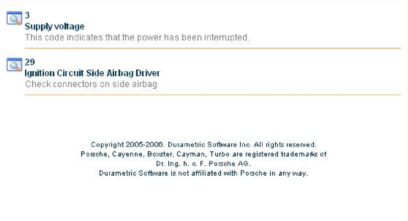

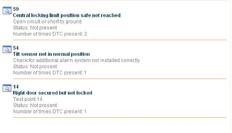

I have these error codes. I am very confident they are related now as I was having intermittent lock issues.

The error codes should provide you with a clue. That is with proper documentation the error codes should be documented along with steps to perform a proper diagnosis that narrows down the source of the codes.
Some of the symptoms you report were occurring in my Boxster and the tech with a diagnostics computer and the security alarm codes traced the source of the problem to a bad door lock switch.
So without the benefit of having the diagnostic steps at hand, all I can offer is in general several not directly related errors or several odd symptoms involving doors/windows is sometimes due to water in a door.
If so and if ignored the electrical gremlins can begin to appear at other places which confuses things.
Another explanation is water in the cabin, on the floor is a common spot and of course this gets the security module wet and then all sorts of odd things generally with the car's locks/doors and such occur. Blocked body drains are often the source of water in the cabin and on the floor.
If you find no signs of any water/moisture/dampness then a simple -- so to speak -- switch failure can be the explanation, as was the case with my Boxster.
