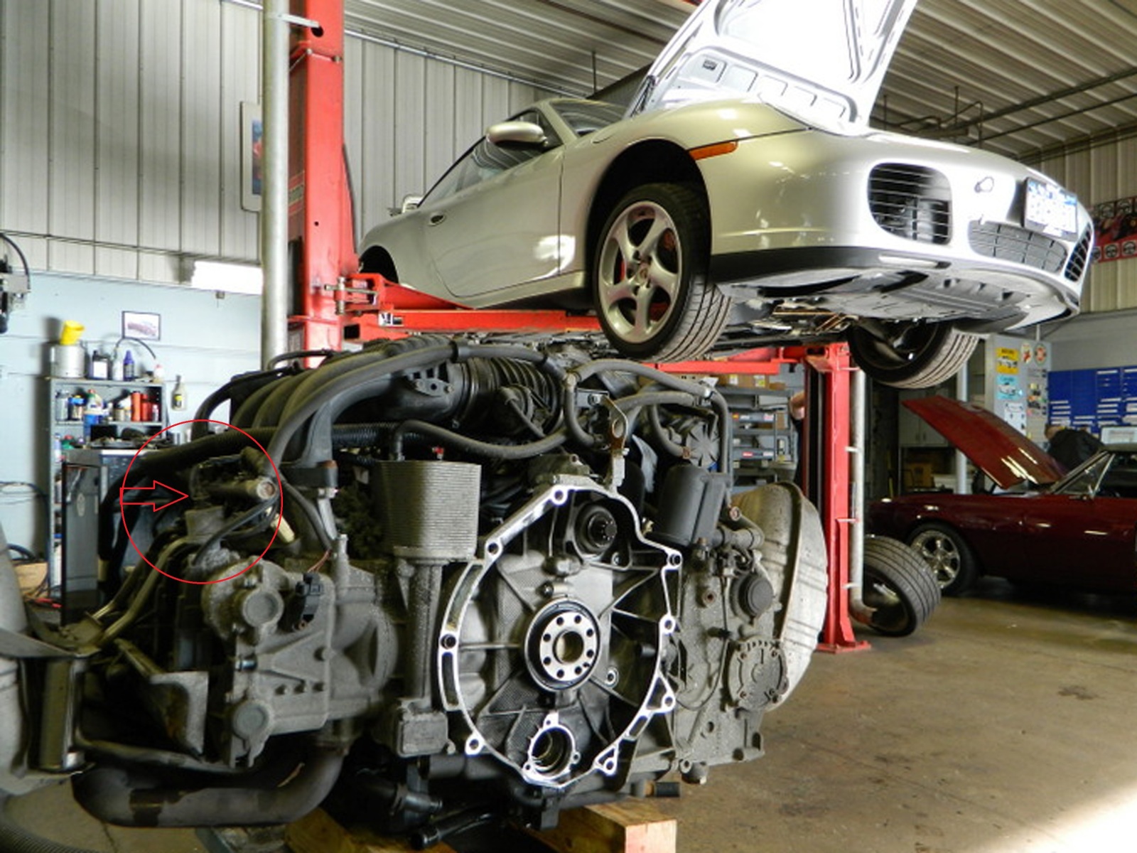

The item listed also got unplugged by accident when installed some of the IC piping. Can anyone tell me its function?
