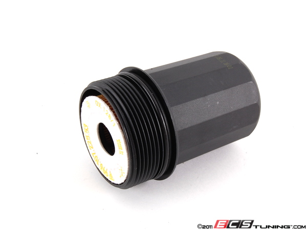

We offer the complete factory oil filter replacement kit, like the one shown below. We also offer a variety of filters. For more information Click Here.

From the pictures of the filter, it looks like it is a cartridge that drops in the threaded holder. I assume that you can still cut open the filter to inspect it just as you can do with the standard filter?
