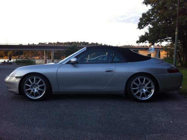

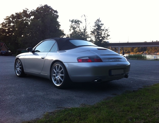

I am running 30 mm H&R spirngs on my car, works great, and looks even greater
good looking cab !! I like exactly how it sits. how does it feel coming into corners? Bouncy at all?

silverfizz has much to be proud ofsilverfizz has much to be proud ofsilverfizz has much to be proud ofsilverfizz has much to be proud ofsilverfizz has much to be proud ofsilverfizz has much to be proud ofsilverfizz has much to be proud ofsilverfizz has much to be proud ofsilverfizz has much to be proud of
thx!
Well, it is wery nice to drive, not that bouncy, feels "tight" and more secure. But ofc you can feel that the car is lower than original.
All over I would really recomend it!
