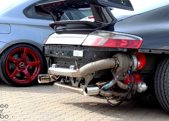

Im going to charge you some pics of everything before I answer any more!
Look agt the nipples on your water pump. Im sure it is the same pump as mine but you want ones that match the inlet/outlet on your pump, intercooler, and third radiator.
The filter in the kit MUST be a dry filter. My dry filter I got from TPC is grey as well. DO NOT RUN AN OILED FILTER! I ruined my MAF doing that.
I am talking about the hose you will use from the filter down to the turbo inlet. That hose, you will want to make sure is silicone. All the other red ones are ok to use.
