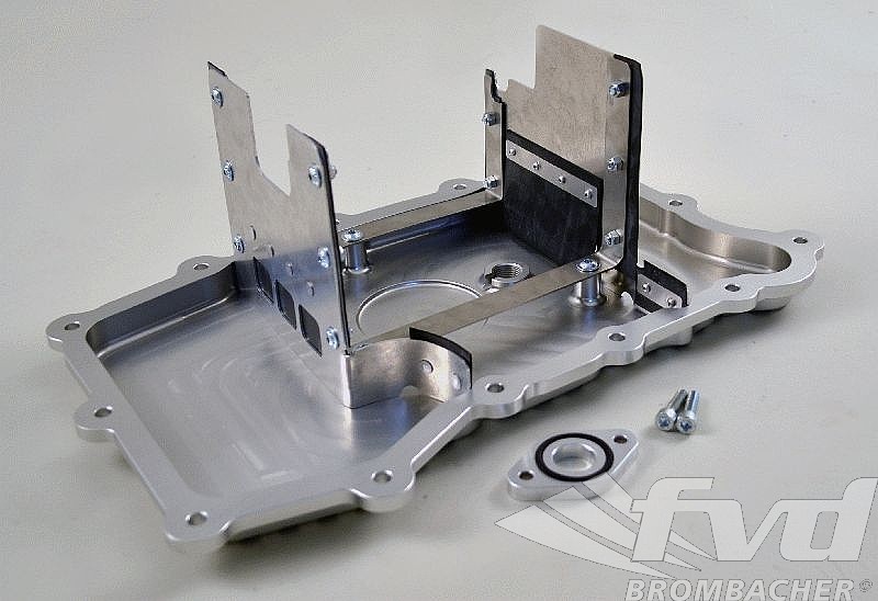

I went with the FVD deep sump on my 99 even though it was the most expensive of the options out there. I liked it's overall profile from a depth standpoint and if I remember correctly it was the only unit that comes preassembled with it's own baffle system. Installation was a snap, just pull the stock sump plate, remove the oil pickup and reinstall with the provided spacer, clean the engine case, install sealant on the new sump plate (I used loctite) and bolt back up. Refill used 11 quarts. I'm averaging 1 to 2 track days a month and didn't want to worry about the oil system.

You are correct, it does come preassembled and has the X51 style baffle. It is $ 254.00 less than the 2 qt kit mentioned above.
Also, don't forget to mention that you are a 6 speed member prior to purchase and pm me, as we always take care of our forum members.
Here is the link to our website for more details....

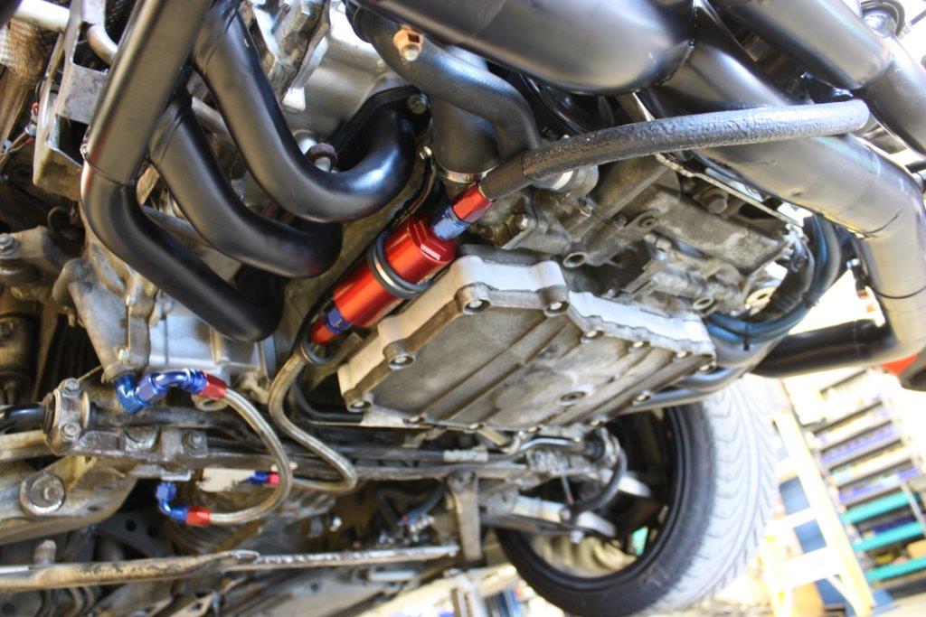

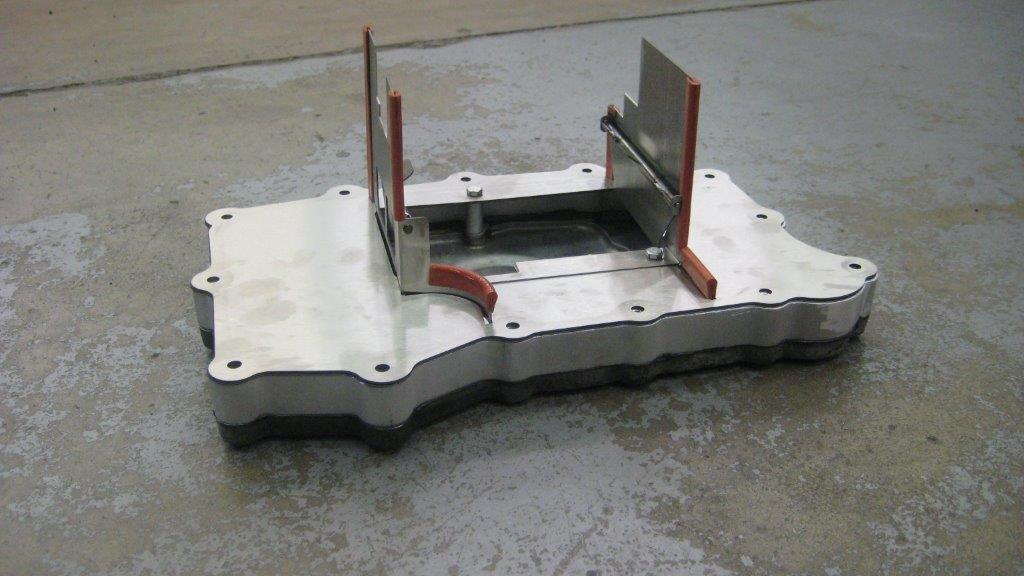

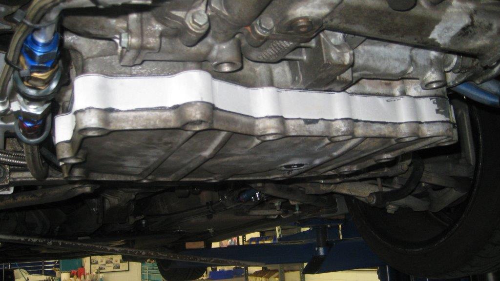

I have the LN Engineering Dry Sump, purchased and installed by Patrick Motorsports in Phoenix.
http://www.patrickmotorsports.com/pa...ump-extension/
