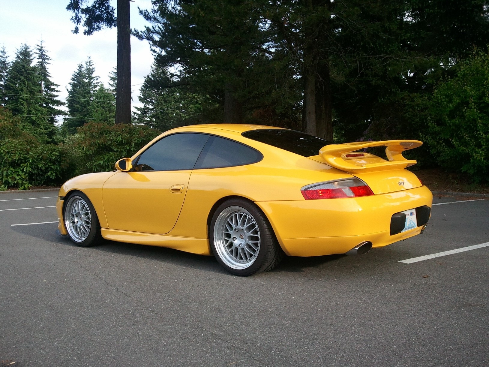

I have 2000 NB that I run on the track with two different sets of wheel/tires that have no rubbing. My car is probably lowered about 25-30 mm if not more. They are as follows:
1) 18x11 GT3 wheels with 63 mm offset. R888 Tires are 295 30. I may put spacers on since they are not flush but this is what I use on the track so no big deal.
2) 18x10 Cargraphic wheels with 47mm offset which is a pretty aggressive offset. Running 285 30 BF Goodrich tires. This combination looks awesome. Can't wait till track season is over to put them back on. Pic of these are attached. The GT3 wheels with the 295's are probably in about 5 mm from these.

As I said before, I am running 295/30s on 11 inch wheels with 63mm offset. You will have no issues on 10 inch even with the 2mm difference which makes up for the narrower wheel you have. However, I do think you will want spacers to move away from the stock offset which I personally don't like on my 2000 NB. Thus, the cargraphic aggressive offset.
