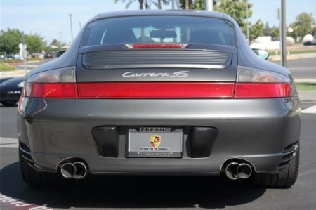

More pics coming soon
Old Sep 2, 2014 | 05:21 PM
jhthornley's Avatar
Joined: May 2009
Posts: 234
From: Charlotte, NC
jhthornley is a glorious beacon of lightjhthornley is a glorious beacon of lightjhthornley is a glorious beacon of lightjhthornley is a glorious beacon of lightjhthornley is a glorious beacon of lightjhthornley is a glorious beacon of light
the @$$ on that is sOOOO sexy. congrats. Hope it works out for you
Those hips! Congratulations and welcome to the 6. Look forward to seeing a few more pictures after you get done driving
