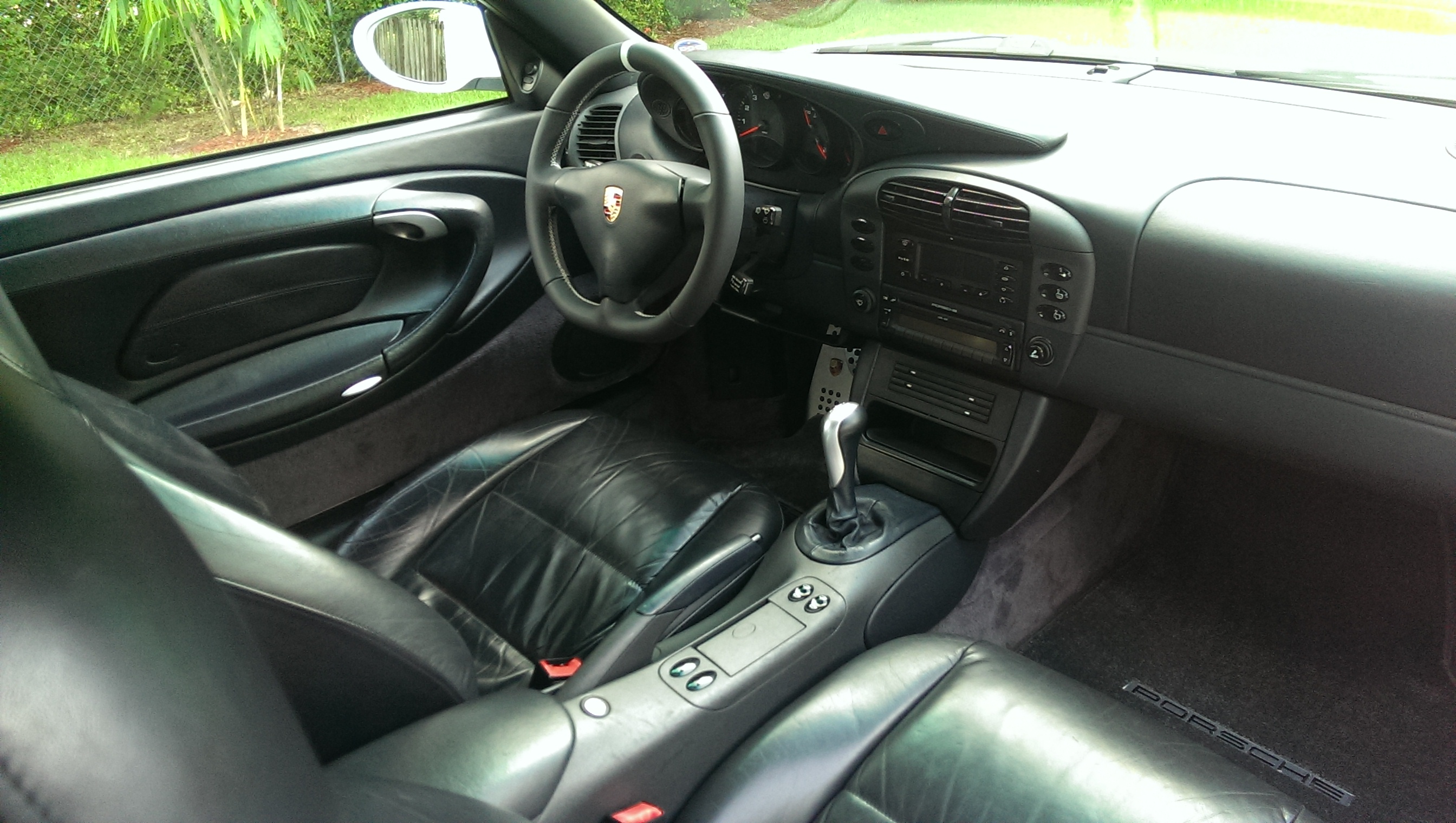

There's a few options available for upgrading from the four-post steering wheel. The three spoke factory wheels are a direct fit. To save money you can E-bay a matching airbag. I went with a DCTMS T96 steering wheel in Metropol blue with the flat bottom white stitching and white stripe at the apex. Metropol blue airbag from LA Dismantlers. Regarding parts, there is the air bag bracket and 5 torx screws that need to be obtained. Regarding the installation, the battery needs to be disconnected and if you've never removed an airbag it's a fun filled few minutes of anxiety. However, the most difficult part of the process is centering the steering wheel.
