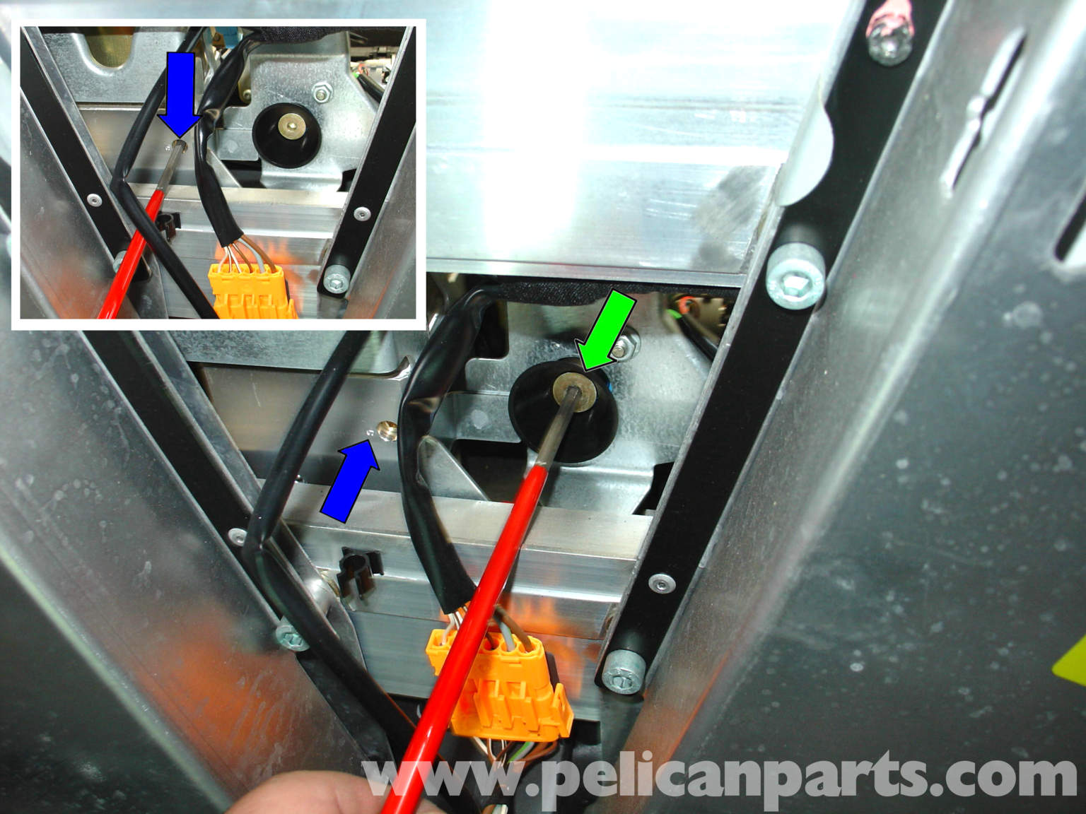

I think now you will have to go into the 'emergency procedure' to close the top. You will find instructions on how to accomplish that procedure in your owners manual if one came with the car. http://www.pelicanparts.com/techarti..._Mechanism.htm If you cannot locate the special tool then you can use 2 small (but not very small) Phillips screw drivers to move the cog wheel when sat in the passenger seat, above your head under the pop out plastic covers. That will extend the hook and latch it. The bobble wires has to be in place to tighten down the top. Unfortunately the clam shell part I have not used. I think that part is behind the rear seat on the drivers side. Read about having the top re calibrated after the emergency operation. Something about not trying to open/close it via the key or the rocker dash switch. Number 7 photo of that link does not look anything like my latching system of the 1999 Cab. Your 2000 may be the same. If not let me know and I can explain fully how to move the latch with the 2 Philips screw drivers previously mentioned in this post. PS please let me know how things are going. I may need to change my pistons some day.

I was able to get the front latched using the top tool, but no, mine does not look like the pictures either. As for the clamshell, there was a little bit of an issue as the screw in Figure 13 of the Pelican Parts article kept falling out. There is a square drive underneath it that I was able to actuate with a 8mm 12-point socket and all locks, latches, etc. on clamshell engaged. Everything feels secure to drive until my parts come in.
