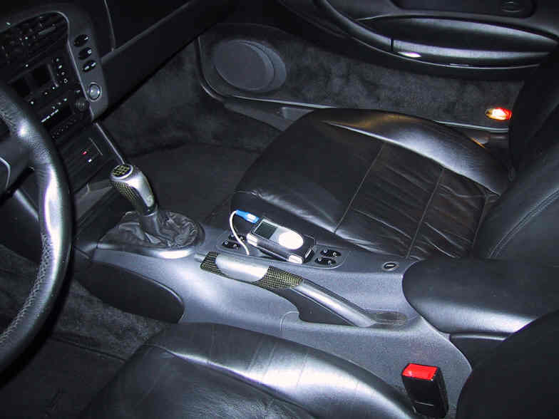

I just did this mod. Upside is looks good and you have the interface for the ipod through the head unit and speakers. Down side is no use of the 6CD stacker. THE CD in the head unit still works.
I ran the cord from the back of the unit up through the center console up through the bottom of the non smoker ash tray (option)
I then went to tap plastic and formed a U shped mounting bracket which I secured with velcro to the ashtray. This allows the ipod to mount to the bracket which you can slide off and on when not in use.

pic attached
pic attached

Very clean install.
