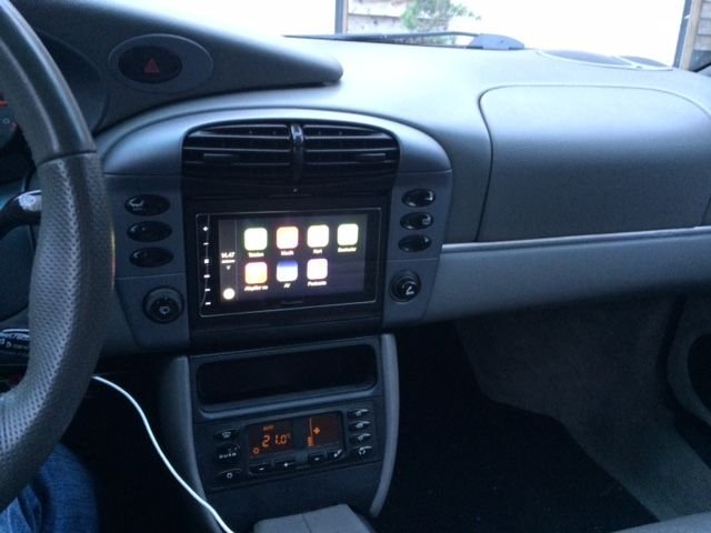

Dear friends. I have just installed my new Pioneer SPH-DA120. Though I still need til connect the safety wire to the + wire of the parking brake switch.
At what place should I look for it? What colourcode am I looking fore?

Solved.
A simple ground wire did the trick. The radio turned on the bluetooth menu and activated the hdmi input when the thin green wire was grounded.

Hi again. I just took a piece of wire and mounted temporarily from the blank metal on the door latch to the adaptor on the thin green wire from the radio, and voila. When the radio registeres the connection the bluetooth menu is opened and you can connect your phone. Once connected the phone will connect again everytime it is near the radio, also with the ground wire disconnected.
You could probably mount the wire permanently to any metal part of the frame. But you only need a permanent connection if you want the passenger to watch movies via the HDMI plug, when driving the car.
