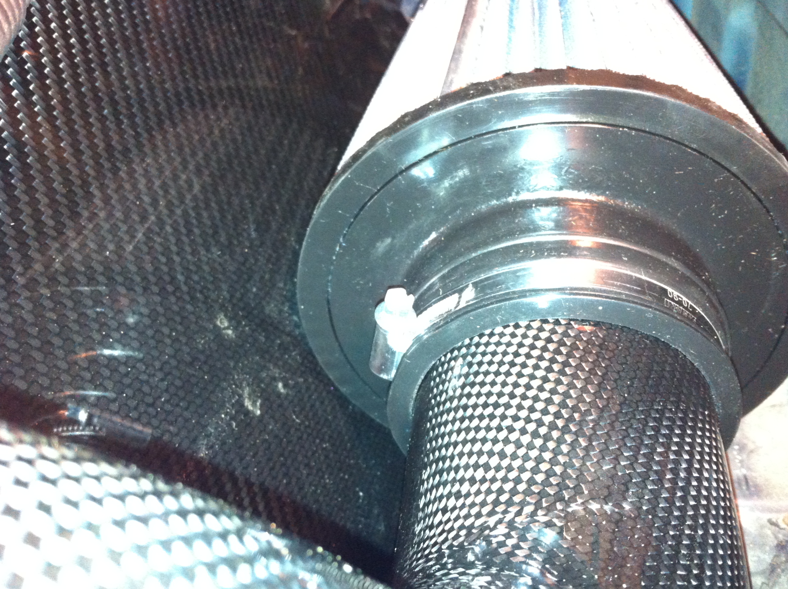

Originally Posted by RGrove
Does anyone else have the issue of the ends of the filters rubbing the strut mount/sai?
you can push the filters a little more inward so it won't rub.
Originally Posted by peteb3
How do you propose to adjust it?
There is no adjustment to be made
exactly, there is NO more room to adjust. the right filter is to its max against the shield. The left filter barely have any room to move. Maybe if the filter is a little smaller, its possible to have some wiggle room.

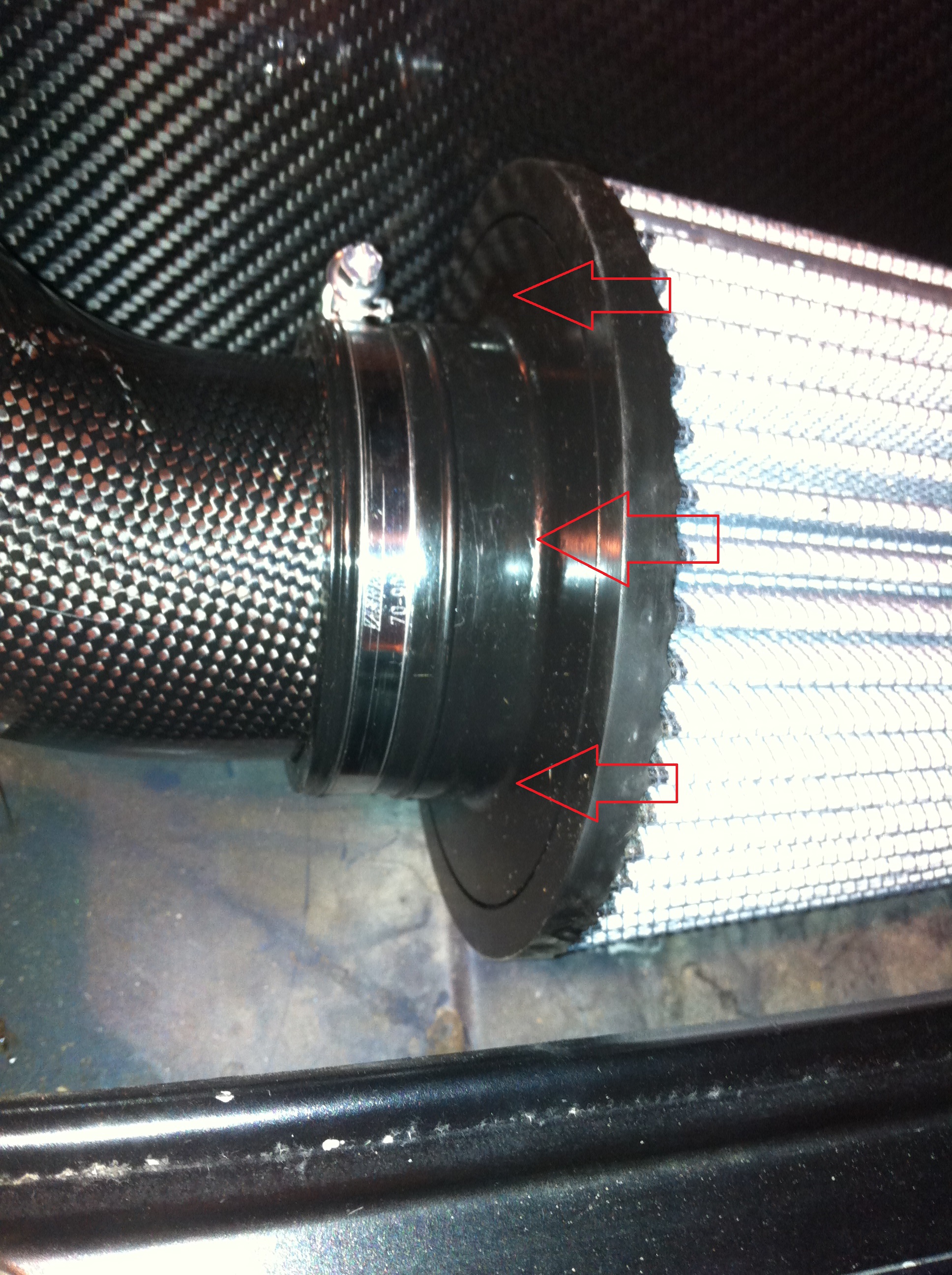

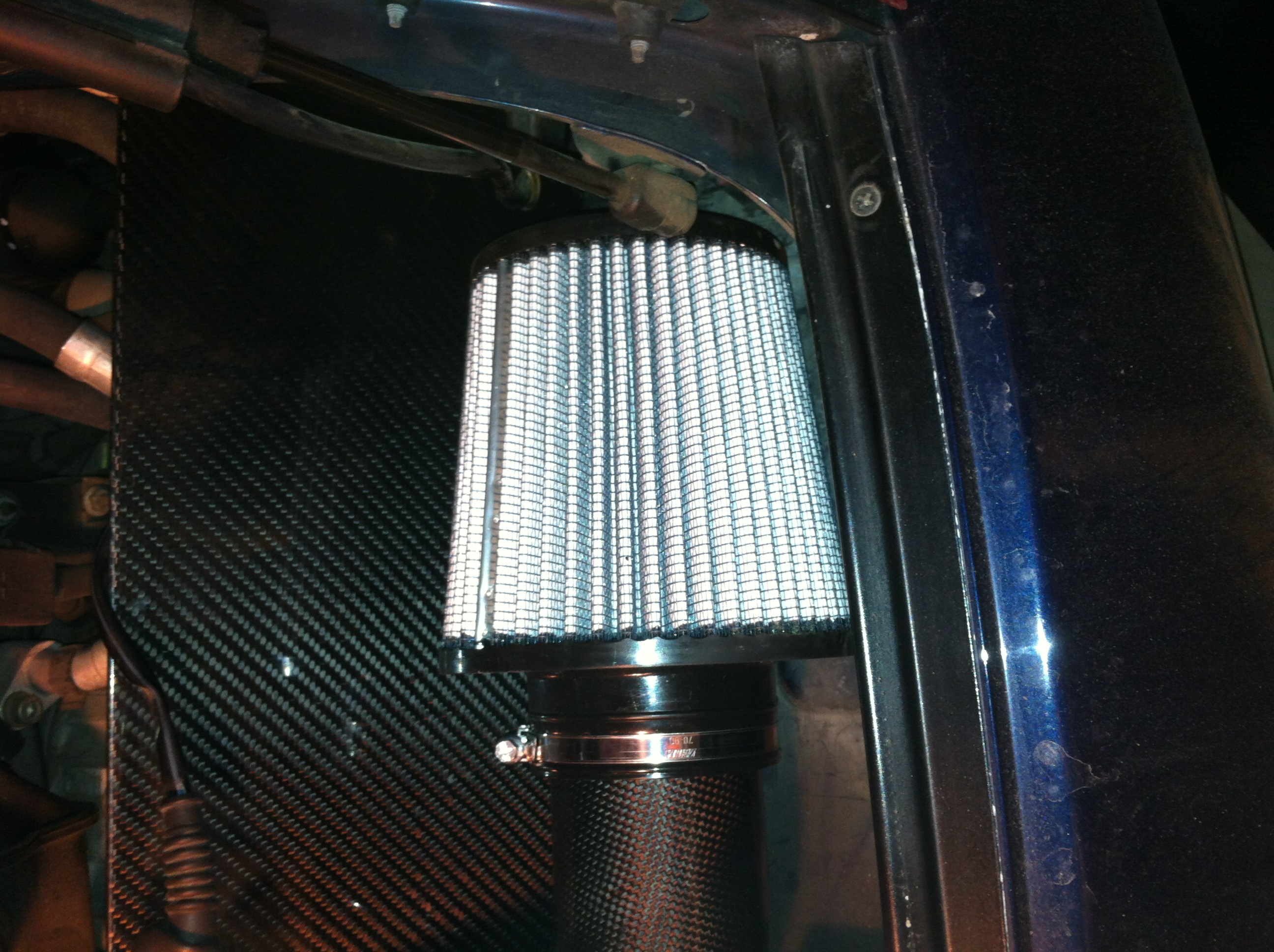

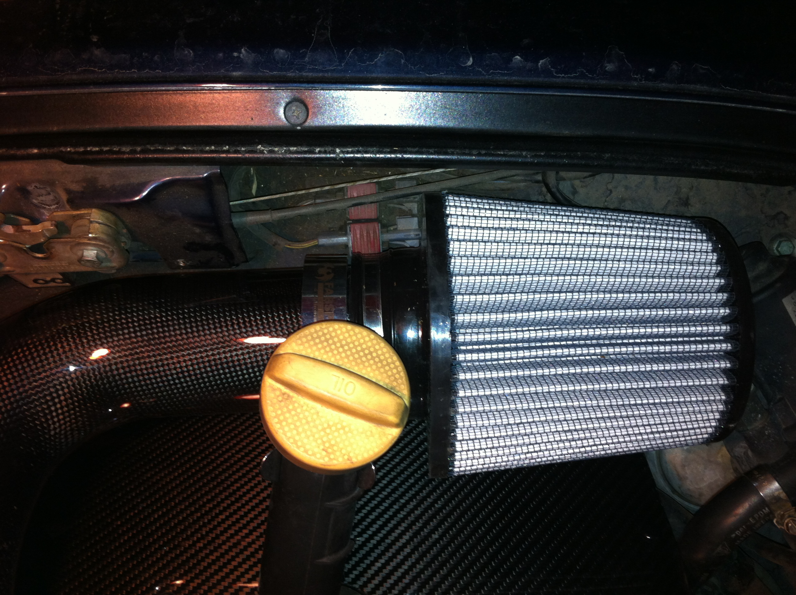

They are pushed in as far as they can go....
the tube ends doesn't have to stop where I marked the red arrow
before & after pics 2 & 3
Be careful to not push the tube too far into the intake filter or you won't be able to take advantage of the built in velocity stack(not sure if new version have them) which contributes to better air flow and ultimately hp.
