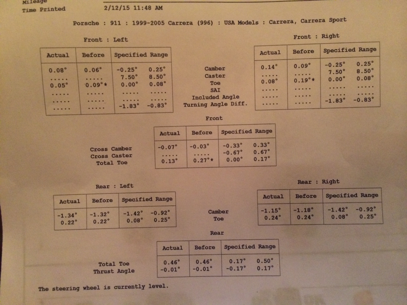

Thank you very much for your post. I attached the report for your reference.
File Type: jpg

Front camber looks ok. Each wheel's setting is within tolerance and both are within the max. allowable difference between left and right.
Front caster is missing. This is troubling. Caster is a very important alignment setting. My info is the caster settings between the left and right wheels wants to be very close as too much difference can cause the car to pull to one side or the other. (Caster difference can be used to compensate for the car's tendency to "pull" from road crown. I prefer my car alignment not have any difference in caster. I prefer to "feel" the pull associated with road crown and have to steer to compensate. My reason is where I live/drive roads have varying amounts of crown and some lanes have the crown in the opposite direction so neutral caster is best for me. Caster is not used so much now as some cars (dare I say most?) come with no caster adjustment possible. Caster is "fixed".)
Front toe is ok. I initially had it as wrong but I got the settings for my Turbo mixed up with the setting of the narrow body Carrera model.
Toe is +0.083 +/- 0.083. Max. allowable difference left to right is 0.33.
Rear camber is while within spec still has considerable difference from side to side. The difference is not close to the max. allowable difference between sides, but imho the camber should be closer. Camber (at the front) is another setting that can be used to compensate for road crown. As with front caster, I prefer camber (front or rear) *not* be used to compensate for what road crown the tech imagines the car will encounter. My point is that a too big a difference in camber at the rear could account for some pulling.
Rear toe is ok.
What to do?
Well, it is not 100% certain a better alignment would help. However, there is still the question of what is the caster settings?
A good tech would go over the settings with you and assure you the settings should not account for the behavior. Especially since you brought the car in because of drivability complaint.
A good tech would certainly give the steering/suspension a thorough check for any loose bushings, signs of damage, etc.
BTW, this includes the bolts/studs holding the front (and rear) struts to the body. In some cases some of these have been known to break and the car can manifest symptoms you mentioned.
