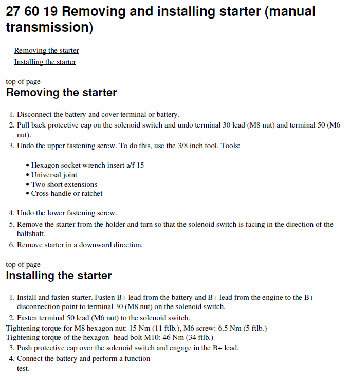

I have followed the instructions here to get access to the starter:
http://www.pelicanparts.com/techarti...EC-Starter.htm
I should be able to test with a volt meter and see if the starter is getting power when the key is turned. If not, can I assume that the starter or starter solenoid is bad?

Is the starter solenoid on a 1999 996 part of the starter, or a separate component?

From the manual, it sounds like the solenoid is part of the starter...

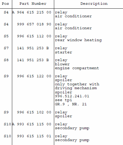

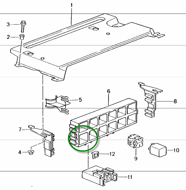

Looking at the parts catalog, if you are certain that your battery is good... Perhaps the starter relay (S7) could be damaged. It's not in the front - description says - central electrical system rear end. There is a block of 12 relays (2 rows of 6).
