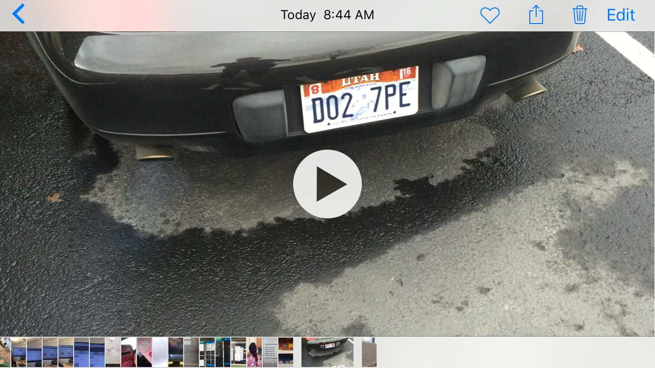

Originally Posted by Porschetech3
Blue smoke on cold start up is very common on flat six engines, and normally does not indicate a problem (some do it and some don't)unless it is extreme or sustains for a long period. Due to the horizontal piston /cylinder design oil can seep past rings more easily than V or in-line engines. Having smoke just on one side is a bit odd unless the engine was tilted a bit while sitting. If this condition persists on every start up ( just on one side) it can be an indication of a scored cylinder/piston on bank 2 cylinder 4-5-6. I would have someone look into the cylinders on bank 2 with a borescope to check for damage .I hope this is not the case but I have seen it on quite a few m/96 3.4 engines on bank 2. If scoring is significant it will usually be accompanied by a ticking or tapping on that side of the engine. If this problem just started at the same time your drivability issue started then the smoke could be the result of A/F mixture being so rich that it washed down the cylinder and caused the smoke on start, if that's the case fixing the drivability issue will solve both problems.
See the left side blue smoke stream. Parked on level ground all night.
