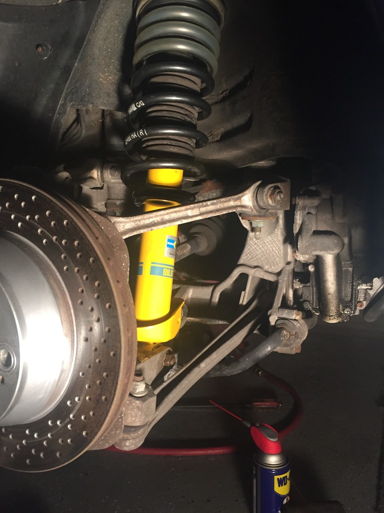

Bilstein B8 sport shocks with H&R lowering/sport springs.
So far I've mounted and torqued the rears...
Still working on the fronts (C4), hopefully I'll finish them up this week (only working nights for a couple hrs.)

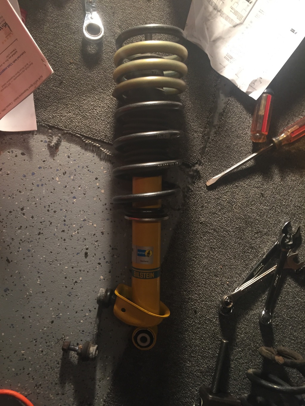

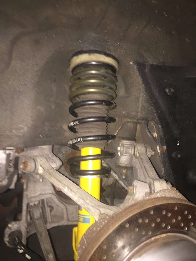

I finally got under and into the car. I have H&R shocks and coilovers. Do you know anything about those? They're adjustable. I haven't seen the camber plates yet, but I still suspect they're factory. Would someone put an upgraded suspension in and neglect the camber plates?
