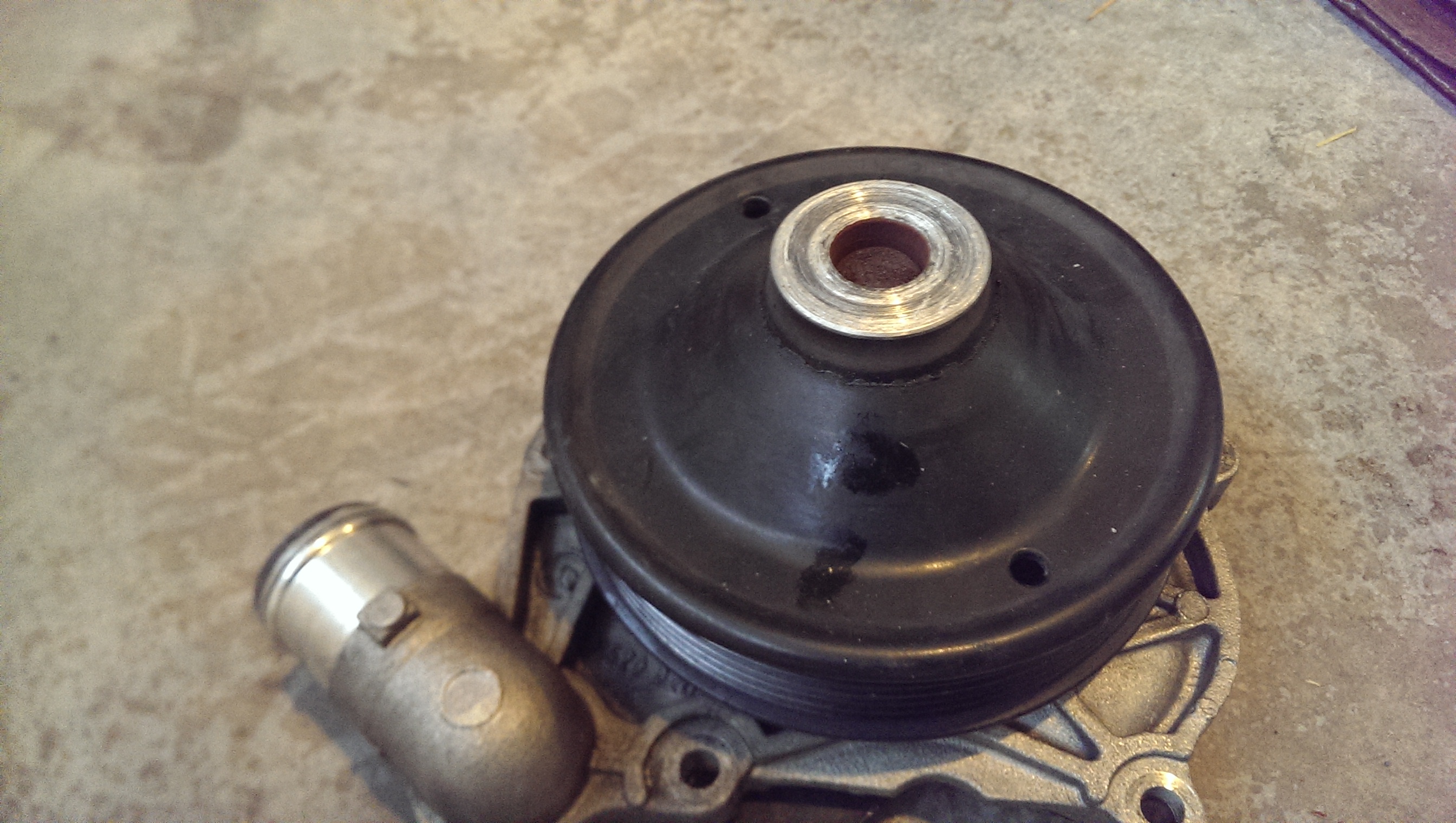

Thanks for all the help. Getting the water pump out was a MAJOR PITA! I could not get the pump out after removing the bolts and moving the plate. It just wouldn't slip out the bottom (even after removing the thermostat housing). I ended up using a rubber hammer to force it out and then I discovered why it was such a PITA. The pulley had moved off the bearing shaft more than 1/4" so it was too big to slide out (see pic). As you can also see from the picture the face of the pulley had been grinding off since it was making contact with the engine mounting plate which is why it didn't fall off. I guess it was definitely time to replace it. The impeller blades where all there, even though some were a bit crunched from my attempts to remove it. Putting the new pump in was easy compared to taking out the old one. Now I just have to wait for the new thermostat to arrive since I didn't plan on removing that when I started this job so I had to order one on the weekend. I'm hoping to have everything back together this week.

Excellent! Glad you got it off. Glad the impeller blades were there. Too bad the pulley came loose. I've not heard anyone talk about that failure mode. Perhaps Mr Hurdi will chime back in as he has been around much longer than I and may have more info.

Not a common failure mode at least one I'm aware of.
While I don't doubt the water pump is bad, the leak is proof enough of that, unless you can move the water pump shaft back and forth a good distance I have to believe -- want to believe -- the engine is out position, could be moving about due to bad mounts -- and allowing the water pump to come in contact with the brace.
The engine mounts are good, but as you can see in the photo, the pulley shaft is approx. 1/4 (or more) recessed from the face of the pulley. On the new water pump the pulley face is flush with the end of the shaft. What made me notice this was when I put the two units (old and new) next to each other on the floor and noticed that the new one was shorter than the old one. It was then that I noticed that the pulley had started to walk off the shaft.
