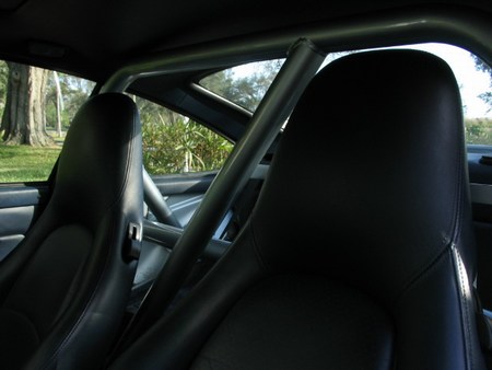

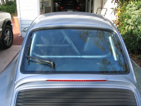

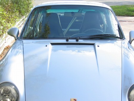

Here are some pics of my 993 Autopower roll bar.

I actually had the dealer paint it (Polar Silver of course)not powder coat it. It came out perfect.

LUIS, looks great! It looks like you got the fixed diagonal brace correct? I'm contemplating getting the removable cross and harness mounts on mine as i could still stuff an extra set of wheels in the back for track days that are further away. Then once you get there put the harness on, swap wheels and away you go....
