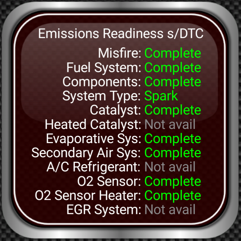

Thumbs up Two weeks later, it passed!!!
Well, it took two weeks and about 300 miles of driving, but the cats look fine now! And the car *just* passed the smog test. A week or so from now my new registration sticker should come in the mail.
Thank you all for your inputs and suggestions, your patience with me, and of course, your experience. I almost ended up writing a $6900 (plus tax) check to my local Porsche dealer ... whom I now have very little confidence in. VERY LITTLE!

IMPORTANT INFO for all 911 owner trying to get pass the smog test. I got this info as I was in Stuttgart, visiting the amazing Porsche factory and museum.If you disconnected or installed a new battery:
This is the oficial Porsche Smog reset procedures:
Start engine, idle cold for approx. 2 min, 10 secs.
Accelerate to 20-30 MPH, Maintain steady speed for approx 3 min, 15 secs.
Accelerate to 40-60 MPH, Maintain steady speed for approx 15 mins.
Decelerate and come to a stop. Idle and KEEP "in gear* for approx 5 mins.
​​​​​​​That's it...!
