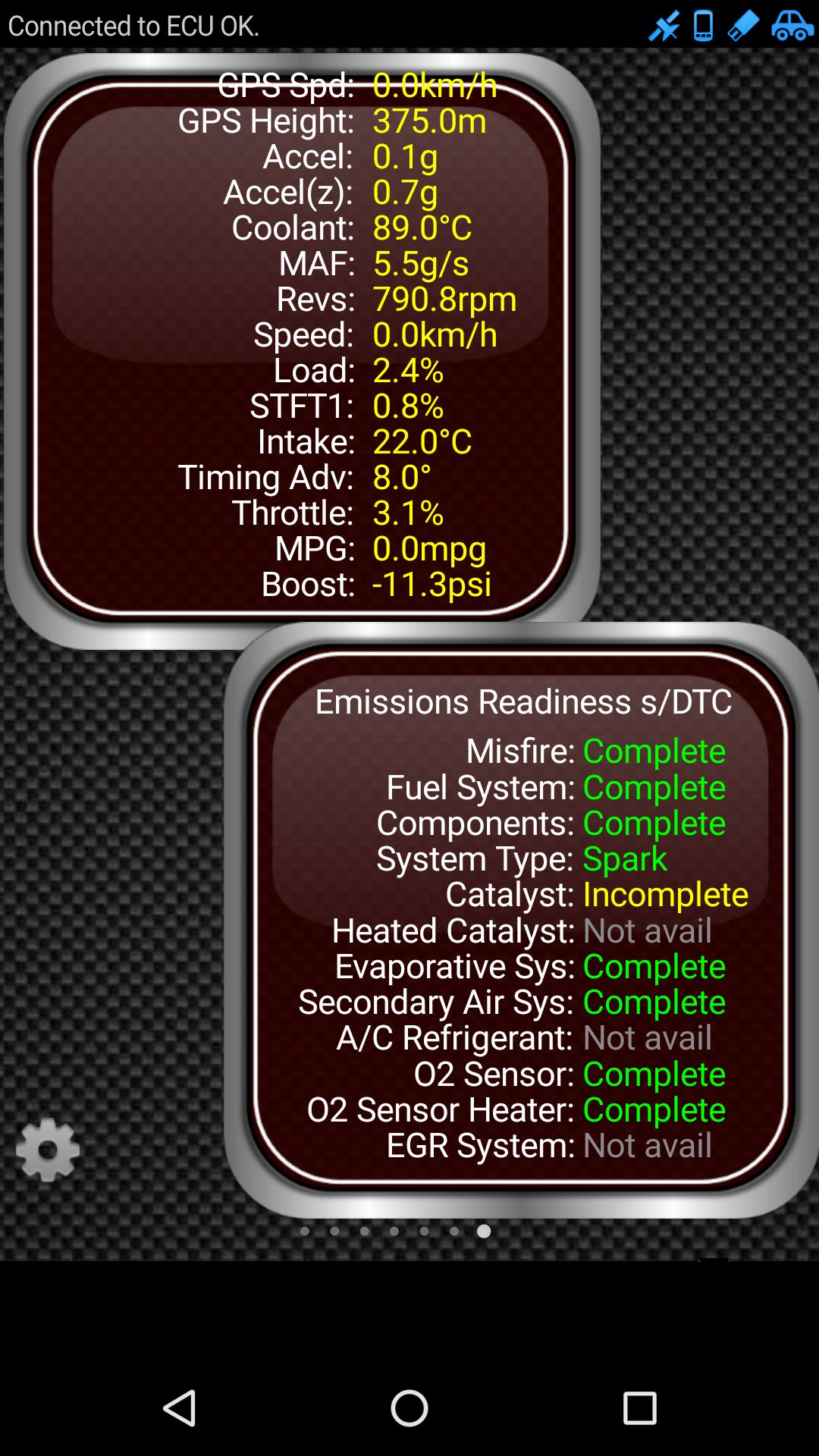

Well, this isn't going as planned - I've probably driven 100 miles since the battery swap - 50 freeway and 50 city - And now, with the new OBDII reader, I can see the reading:
Catalyst - Incomplete
I'll probably get another 40 miles or so today, but I don't like where this is heading. Any thoughts before I call the dealer and find out how much Catalytic Converters run?

That is the incomplete readiness that the scan tool will show...there is most likely nothing wrong with your cats....I asked if you have a check engine light and I am betting you don't....you need a tech that is familiar with the problem...a good tech can take their PIWIS tool and determine what driving is necessary to obtain a readiness reset...I am concerned that your dealer doesn't even know what that is....I guarantee you will have to be very lucky to obtain this yourself...I got up a 5am a couple of times and drove over 300 miles and still did not have a catalyst reset...it has to be done at different speeds for different lengths of time, with a cold start and I believe all under 3000 rpm....very difficult to do without a PIWIS tool to guide you...like I said, have your service manager call the Porsche Fresno service manager, Daniel Buono (559-860-4000) and request that he have his Porsche master tech, Jeff, talk to your dealers Porsche master tech and give him the proper procedure...it will only take them a short while to get a readiness and you will be off to the smog shop and you will pass with flying colors...another hint...make sure to drive your car for a while so it is nice and warm before you go to smog it...good luck...I was without registration for three months due to this battery change issue and my dealer not giving me the right tech when I first brought it in.

Your monitors have not performed the self test .You have to drive the car in a particular way .Fuel tank at least half full ,the procedure varies with each make and model.The basics are 50-55 mph for approx three miles,stop and go 0-35 mph .What this does is allows the ecu to perform self tests while driving to verify emissions system operation.Some cars take hundreds of miles of driving and some only take 2-4 miles of driving to get these monitors to pass.And the vehicle has to be at normal operating temperatures,I did smog test and repairs in calif for over thirty years and to get some vehicles to complete the monitor test was ridiculous .Each time a system repair was done and codes cleared ,or battery voltage drops below 8-9 volts, the drive cycle had to be done as well.

Not sure what's going on.
FWIW, both my 2002 Boxster and my 2003 Turbo manage to set all the readiness codes to complete (this after a clear codes operation) in at least a 30 mile drive from home to the office. This is a mix of a cold start, some idle time, then a short drive on city streets to the freeway and then freeway almost all the way to the office with the last 1 to 2 miles back on city streets.
I don't use full throttle but I'm sure the RPMs get above 3K and in the case of both cars remain there for a while, minutes at a stretch.
The readiness monitors probably get set to complete before that drive is over with but I don't recall ever bothering to check.
I can't believe the "drive cycle" for your 2004 differs all that much from my 2003 Turbo and my 2002 Boxster. Only very rarely does someone post about having any difficulty getting the readiness monitors to set to complete. I would think if the drive cycle was too complicated this would be a more frequent source of posts.
With that device you have, can you check for any pending codes?
Had to offer a guess I'd have to say the converters are suspect but I wouldn't buy new or even used converters based on my guess.
All I can offer is you have to do a reasonable drive cycle. I don't think it can be all city streets or all freeway. I know it can't involve WOT acceleration blasts. Under this scenario the DME goes back to open loop mode and stops monitoring the #2 O2 sensors. My guess (another one) is if this happens this resets at least the converter readiness test back to its starting point. The converter tests take some time as the DME wants to monitor the oxygen level going into the converters and the oxygen levels coming out. This is to verify the converters can store oxygen when there is an excess in the exhaust gases as it is with this oxygen that the converter catalysts metals work their "magic" on the exhaust gases.
You can consult with a Porsche tech to see if he can advise you what's required regarding the drive cycle. Obviously you want to give the DME every chance to flag the converter readiness monitor test to complete so you can smog the vehicle.

There is 99% chance there is absolutely nothing wrong with your cat converters...this is a problem with late model 996 ecu's and the readiness reset procedure...I don't know why people want you to chase your tail when they have never had the problem themselves or had to resolve it...as stated above getting the readiness reset can be easy or a real pain in the ****....if your reset is as difficult as mine was you will never achieve the reset on your own...pay your registration on time to avoid penalties...you will receive your tags when you pass smog...why don't you invest in a phone call to your dealer service manager or another dealer in your area and ask them about readiness reset...they should all be familiar with the problem because every late model 996 with obd2 is a candidate if there was a battery change
