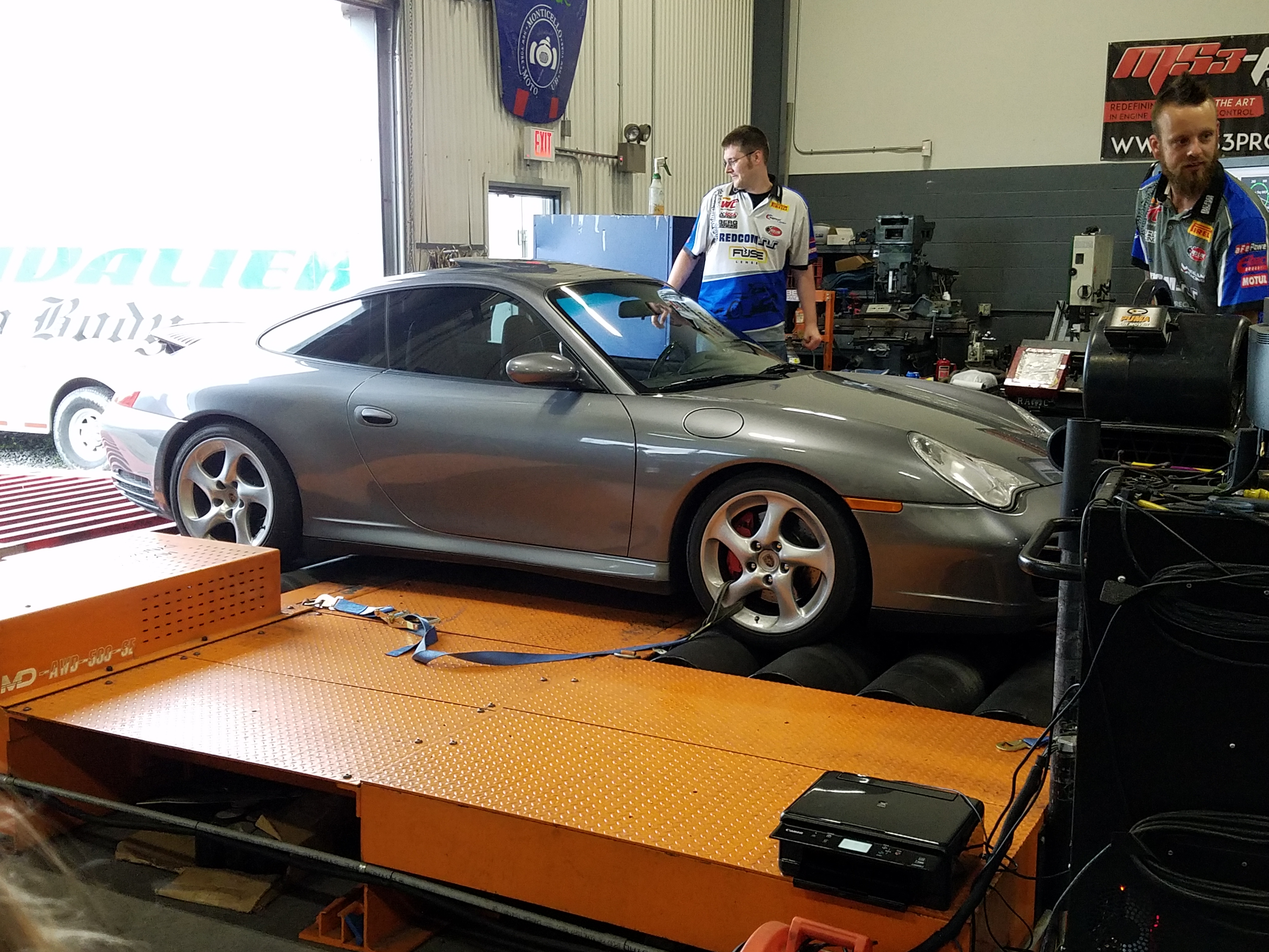

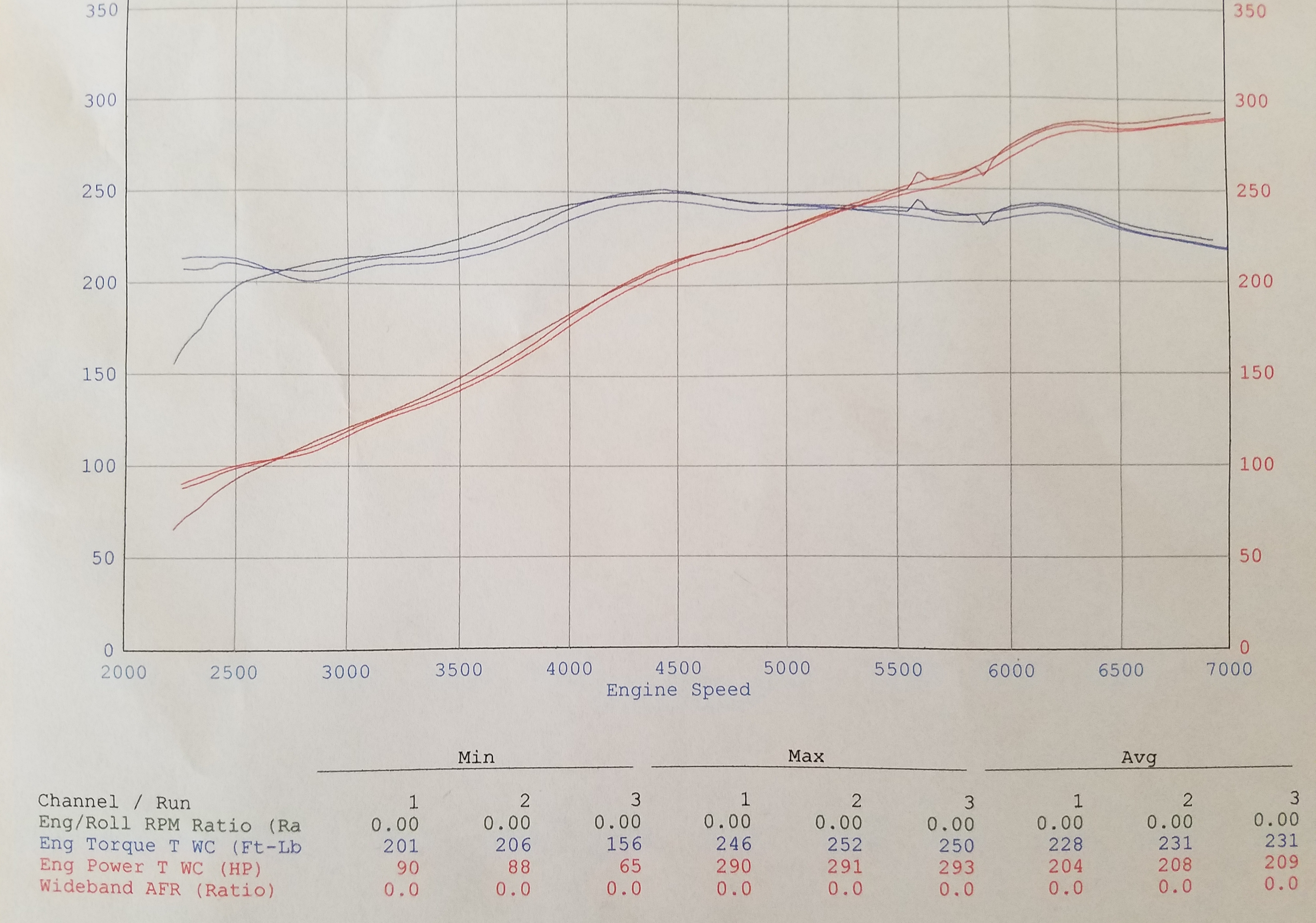

Ayyyy, well I guess I am eating my own words here.
Car dyno'ed 293 whp and 252wft/lbs this morning. It was 70*F, with 95% humidity (was literally raining). Considering this was on original spark plugs, 32 lb rear wheels and with my 4S transmission, I am super pumped. Did not unfortunately get to weigh the car.
And while it was an AWD mustang, I don't think it was a particularly "happy" dyno; there we plenty of wrx and sti owners walking around grumbling, about getting 211 hp with a tune and one 5.0 new gen mustang with a super charger that made 456 whp where the owner thought it should be closer to 500hp at the wheels.
We all know about different dynos and all the variables and blah blah blah, but there was a bone stock 987.1 Cayman S there that put down 254 to the wheels, so I think the dyno was quite accurate compared to factory numbers. Any way, at 15% loss (and my car still has the awd transmission spinning its output shaft and guibo) that would put me at 345 crank hp. Even if it's in my head, I could not be more happy.
One thing I think is outstanding was how unbelievably linear my power curve is; it's like a straight line. My car almost completely doesn't have that infamous M96.03 hp dip at 5700 rpm like all the other graphs I see. I new the car was fast on the track before, and I knew the power delivery was smooth, but I guess this adds some more data to support that.
Huge kudos to EVOMS for what looks like an outstanding tune. Great time today and thanks to everyone hosting. Also, there may or may not have been some highway pulls afterwards, in mexico, with a 500 whp S2000...

By the way, impressive dyno numbers with what I think is minimal spend. I have a Fabspeed X-pipe, no cats & a Gundo hack without a tune at present as I only recently purchased her but tune coming next week. I notice a difference with the little my car has in mods so I'm looking forward to a few more as reading your post is very encouraging.

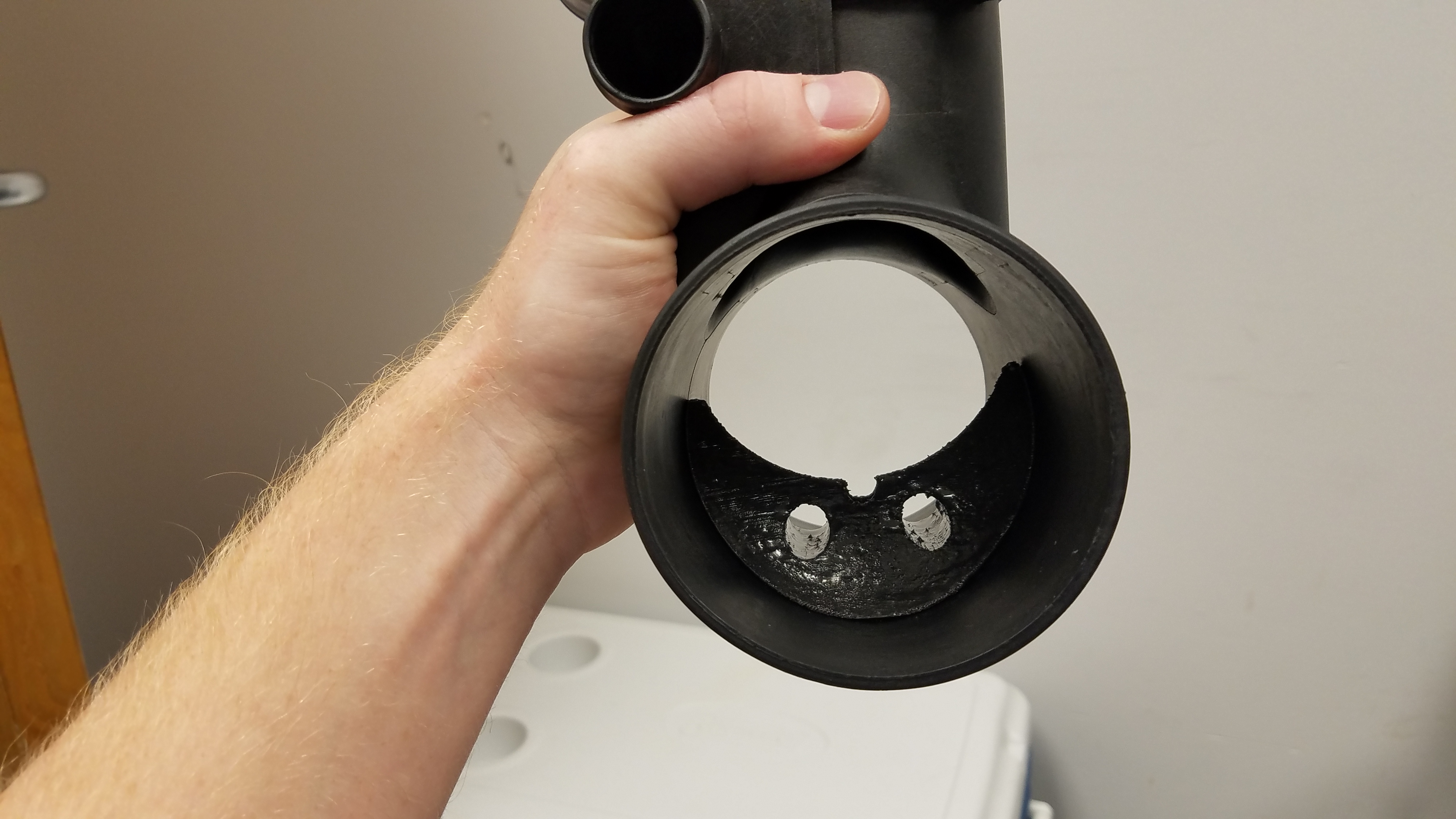

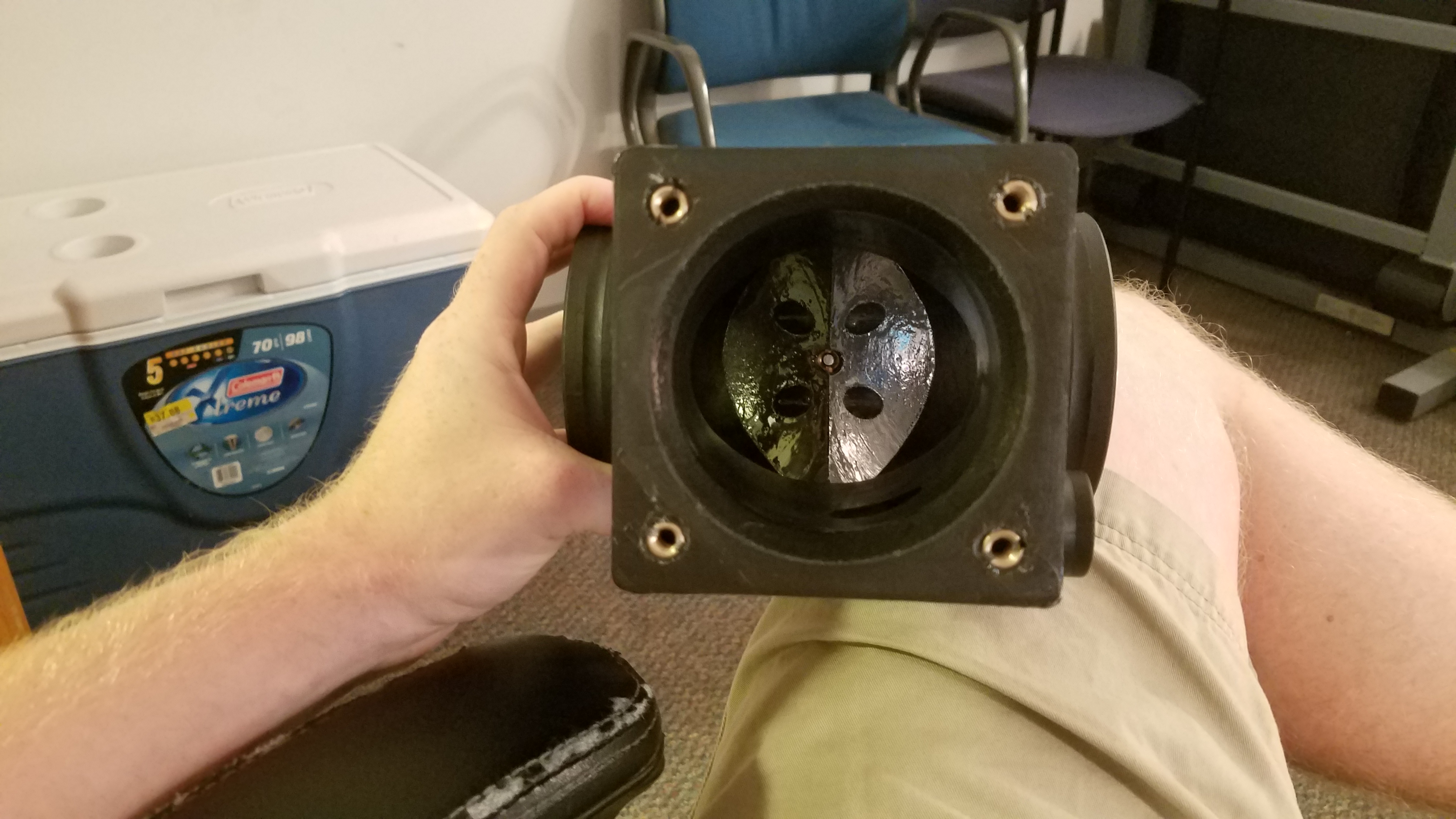

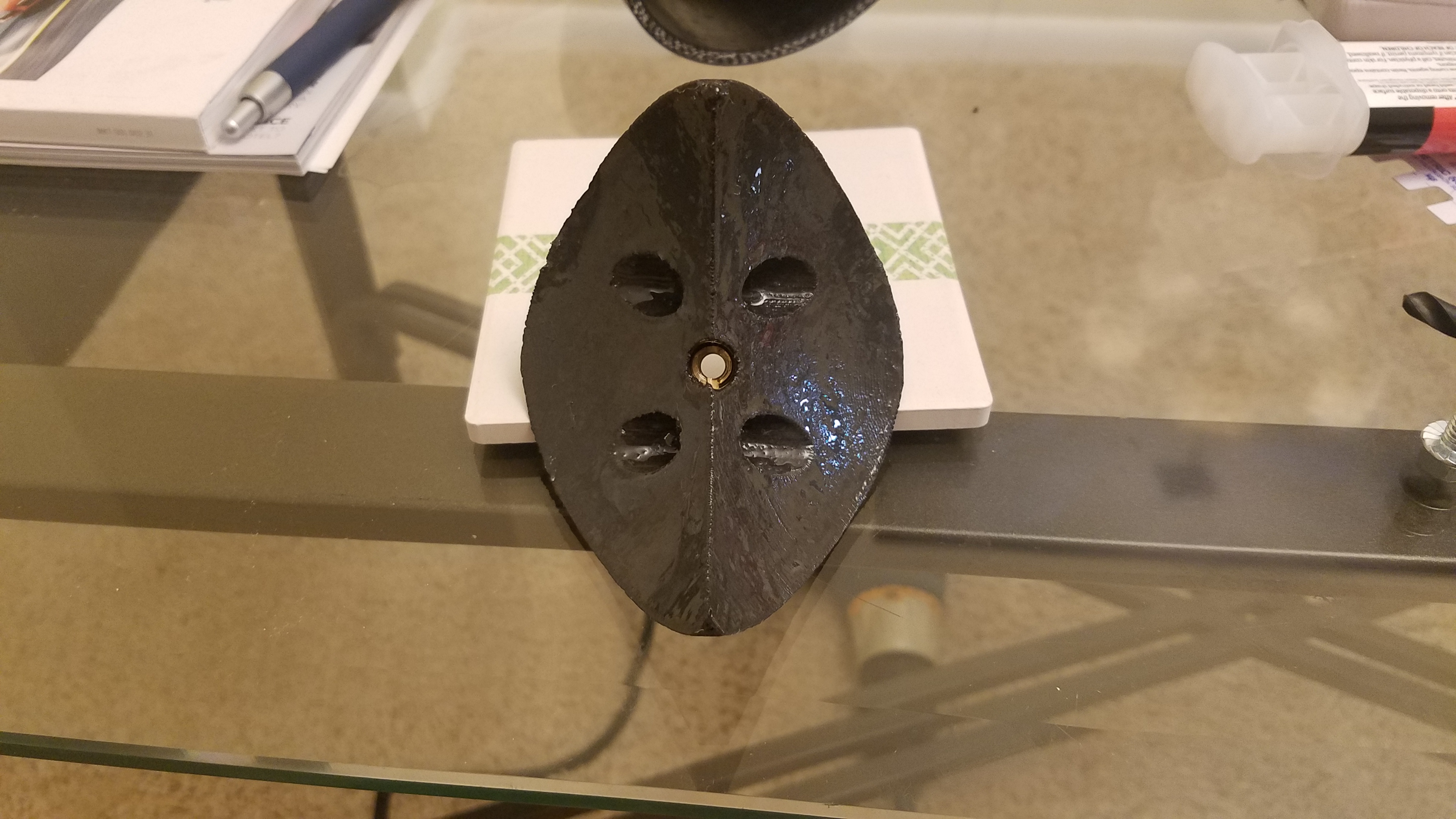

I was able to 3D Print Plenum Adapter for Bosch 82mm TB

I was able to 3D print one out of Carbon fiber-filled nylon (about $80/kilo). I also 3-D Printed a splitter to mount in the back of the stock plenum that mimics the internal geometry of the IPD unit..
used brass thread inserts slathered w epoxy to ensure I could securely bolt things up and used a high quality epoxy to affix the adapter plate to tho stock plenum... had to source some silicone hose off eBay to attach to stock air box..
Results: Improved power, throttle response and sound
*note: car already had fabspeed high flow cats and cheap, but good headers
I put 3000 miles on my car before I sold it.. Materials held up well...
Pics attached ...
If you measure the TB side of the stock plenum and calculate the area of the opening, then do the same for the GT3 TB, you will find that once you subtract the area of the throttle plate/valve from the calculation, the stock plenum has a larger free cross sectional area than the GT3 TB... So this means we really only need an adapter to smoothly neck-down from the GT3 TB to the stock plenum..
Pics attached ...
