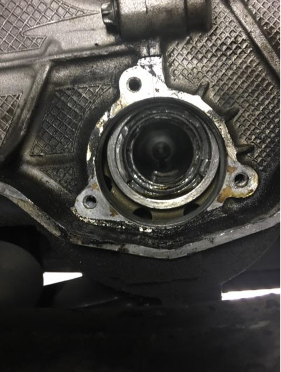

Thy showed my the remains of the IMS- the bearings were totally extruded. Here is a picture of the flange part, it looks pretty chewed up...

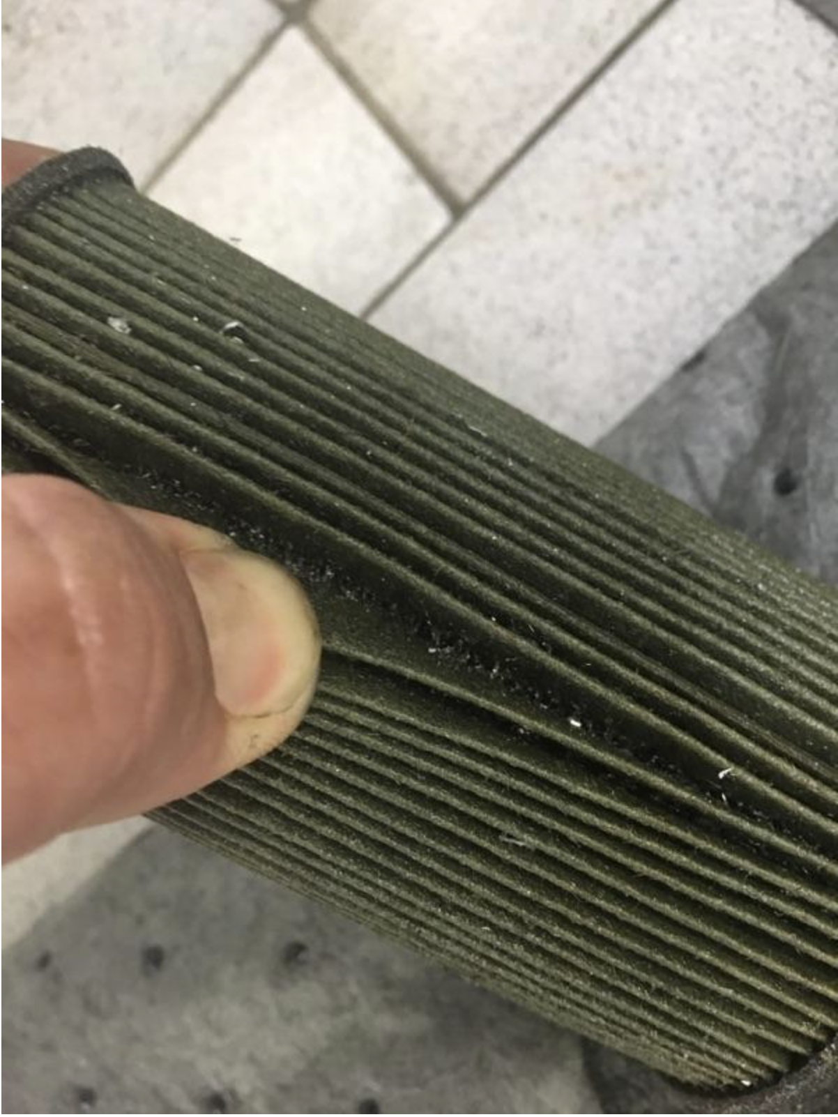

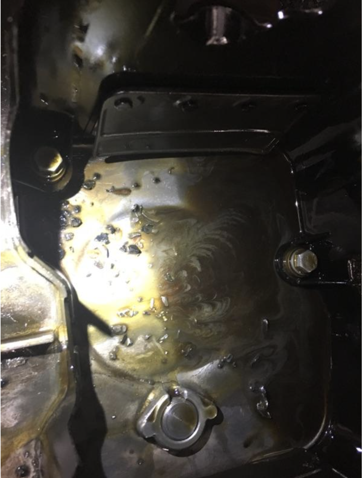

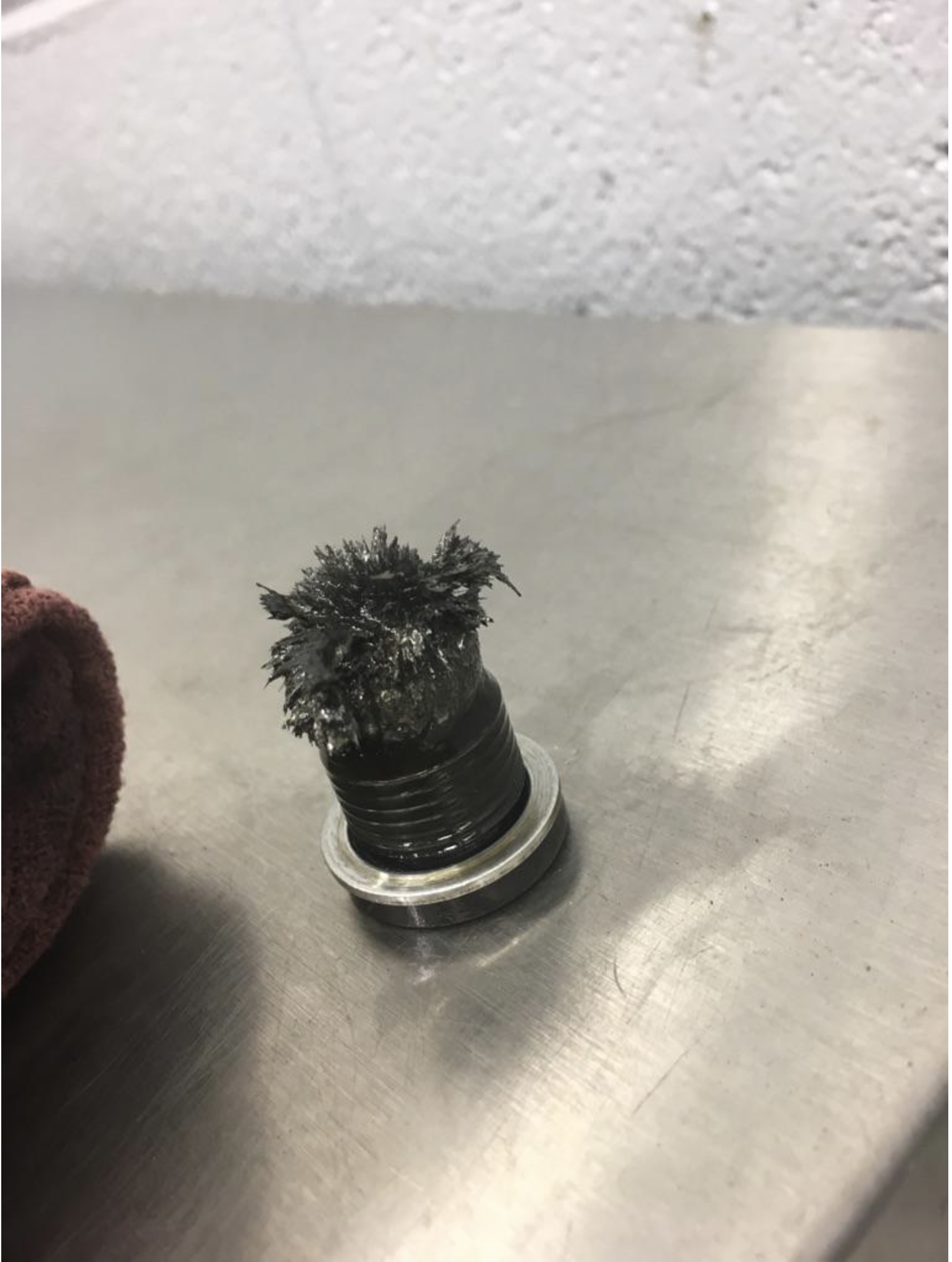

Here are the rest of the pictures of the carnage...

Well, there's no doubt that IMSB is toast.

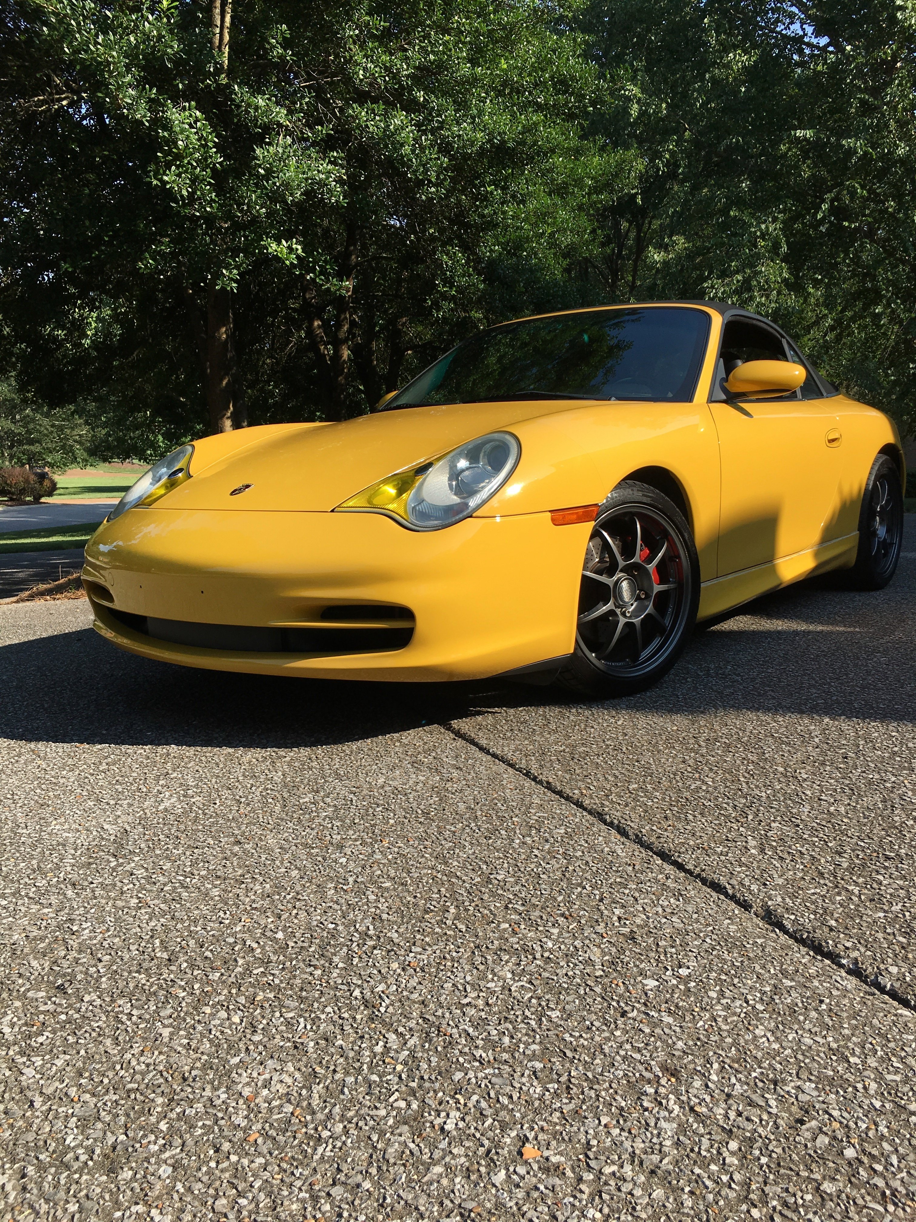

Got it back from dealership.
Runs fantastic and sounds great ( different acoustics for some reason)
Only disappointment is dealership did not credit me PCA discount on parts despite promising they would
Of course, once I was driving I just put it all behind me.
Running in a new engine, and plan another 140K on this one.
No point selling it now.
Maybe add a coupe down the road and keep this for sunny weather...
