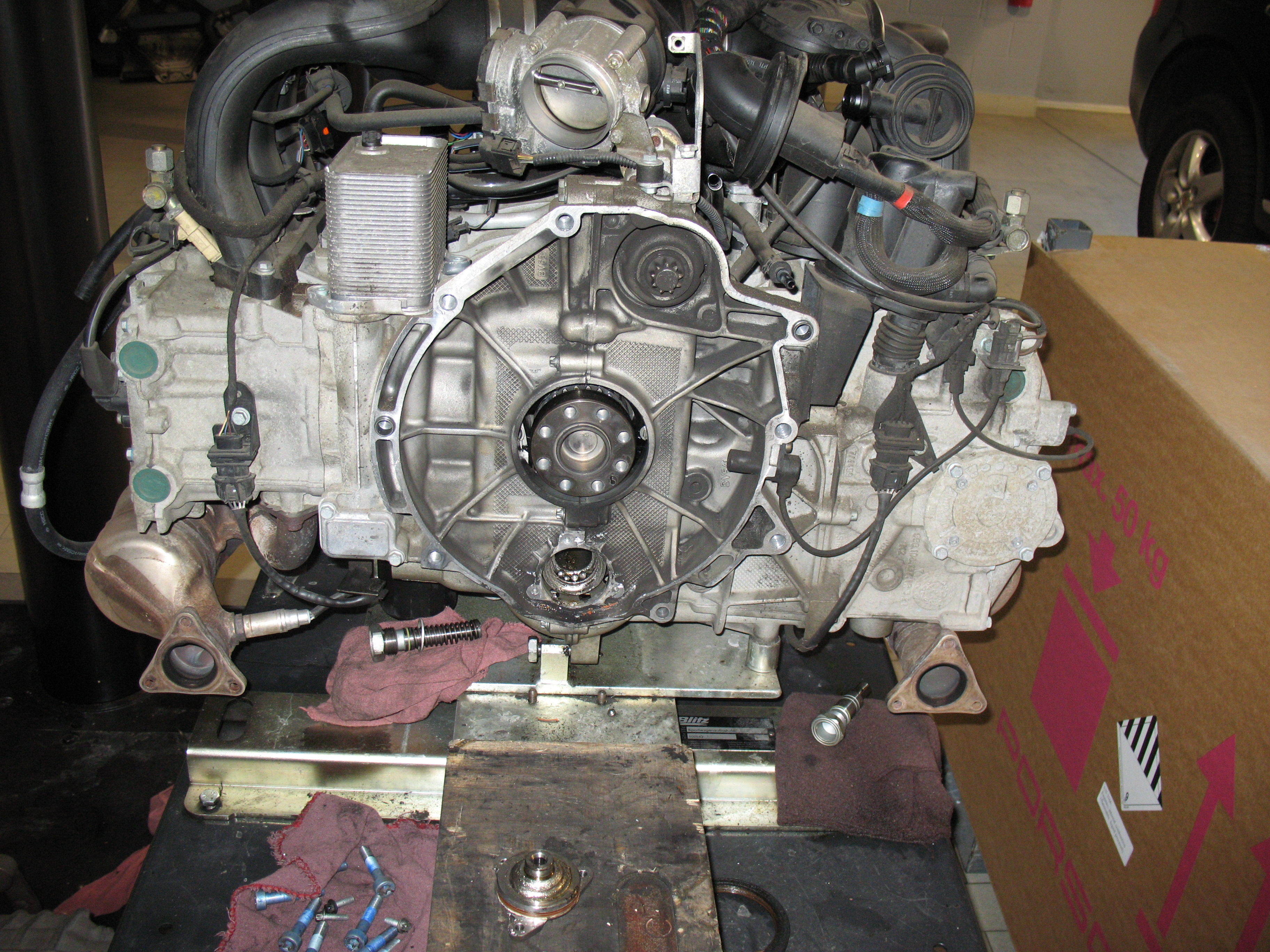

The OP reported the engine was pulled and metal shards found. I believe there must have been some disassembly.
It is not a hard dianosis to make. I've seen two engines, a 996 and a Boxster, in a dealership with a bad IMSB. With the transmission removed the IMS flange is removed and with the bearing exposed it is quite obvious if the bearing is the culprit or not.
See pic for what I'm talking about.

Ha... if it had a bearing like that, "marbles in a can" would have been a mild symptom. From my reading of the original post (and I'm going from memory here) he said it didn't make any unusual noises - it was a CEL that tipped him off...
