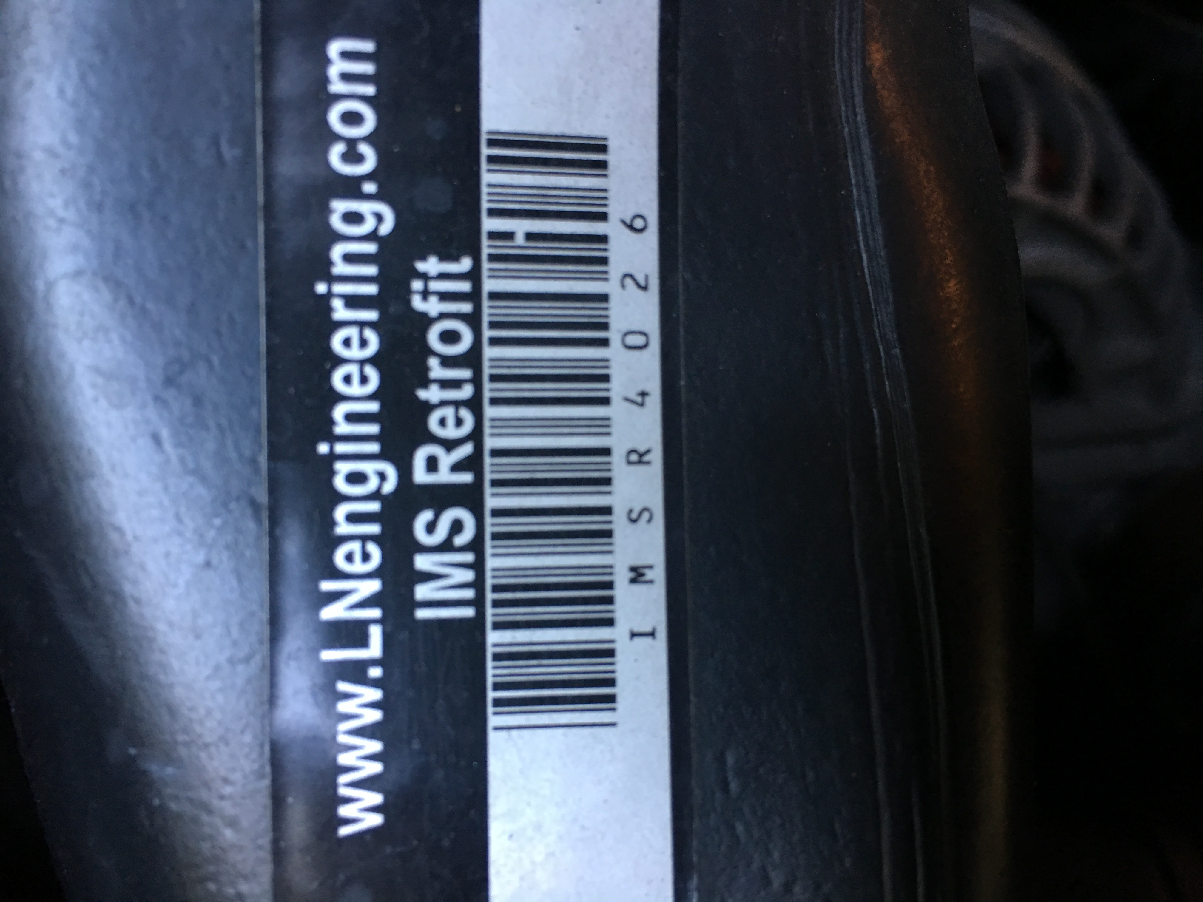

Originally Posted by cnavarro
Sorry to see you have a problem with an engine fitted with one of our IMS Retrofits. At that mileage and especially as you had just had the oil changed and there were no symptoms (if the bearing was on it's way out, I would have expected some debris in the filter), I'm wondering if the IMS was a secondary failure, even if an IMS failure at all. I would have expected you not to have been able to drive it (big oil leak likely) and it would have been making noise and likely would have jumped time having been driven to the dealership.
Was this installation registered and have a serial number I can look up for more details on the installation?
Was a forensic inspection done including teardown? Any scored cylinders? It's taken some time to corroborate our theory, but in most every case we've seen one of our bearings fail with mileage, there have been scored cylinders, poorly fitted cold air intake, or a dry (non-oiled) washable air filter, all which lead to contamination of the oil with high silicon content.
You are not too far from Flat 6 or LN - I'm sure we can do much better for less than the dealer and do updates at the same time. Shipping is cheap and easy. We're not so much in the engine business here, but if Jake does the work, we can get to the root cause and obviously we'll do our best to make this process as painless as possible and I'd help out where I can.
I now have a rebuilt engine from Porsche. It has a sticker which seems to indicate it has an LN IMS:
What would be the warranty on this?
A great outcome and seems very reasonable compared to some figures I've seen. I guess we'll never know if it was the chicken or the egg.
Best of luck with it!

Best to check and confirm with LN but if I remember correctly the warranty on the retrofit is two years/24,000 miles. Also, for the warranty to be effective I think the installation had to be registered with LN so you might want to check that too.

Porsche factory installs LN IMSBs?

Thank you again for this information.
From what I was told this was “ factory rebuilt” and I guess it could have been sitting in storage somewhere.
It certainly looks new.
Anyway, I am not getting ulcers over this - will just drive it and enjoy it.
From the info I now have, will look at replacing the IMS at 60k if I still have the car.
FYI, an IMS retrofit still uses a balled-bearing (albeit improved ceramic hybrid ball bearings) and may still fail. Warranty of a retrofit is 2 years or 24,000 miles with a recommended replacement at every 75,000 miles or 6 years. If you want true piece of mind, you need the "IMS Solution," which uses a plain (no more *****), oil-fed bearing.

Warranty
The dealership gave me a 2 year unlimited miles warranty - by word of mouth, for what its worth.
I decided to do an early oil change ( today ) at my Indie at 2600 miles on the rebuild.
My technician said he found it interesting that I received a short block.
He said that when this issue first came up he was working at a dealership and they would be shipped a complete engine with headers and all, and would just bolt it in and reconnect - a very quick process.
They said it was to keep labor down.
I guess that's not done any more - they used all the old bits on mine and, $8512 of labor later, it was back in place.
Parts were $11000 for the engine, I believe.
They then did things like alignments etc. and the final total , with tax , was $24500 odd
