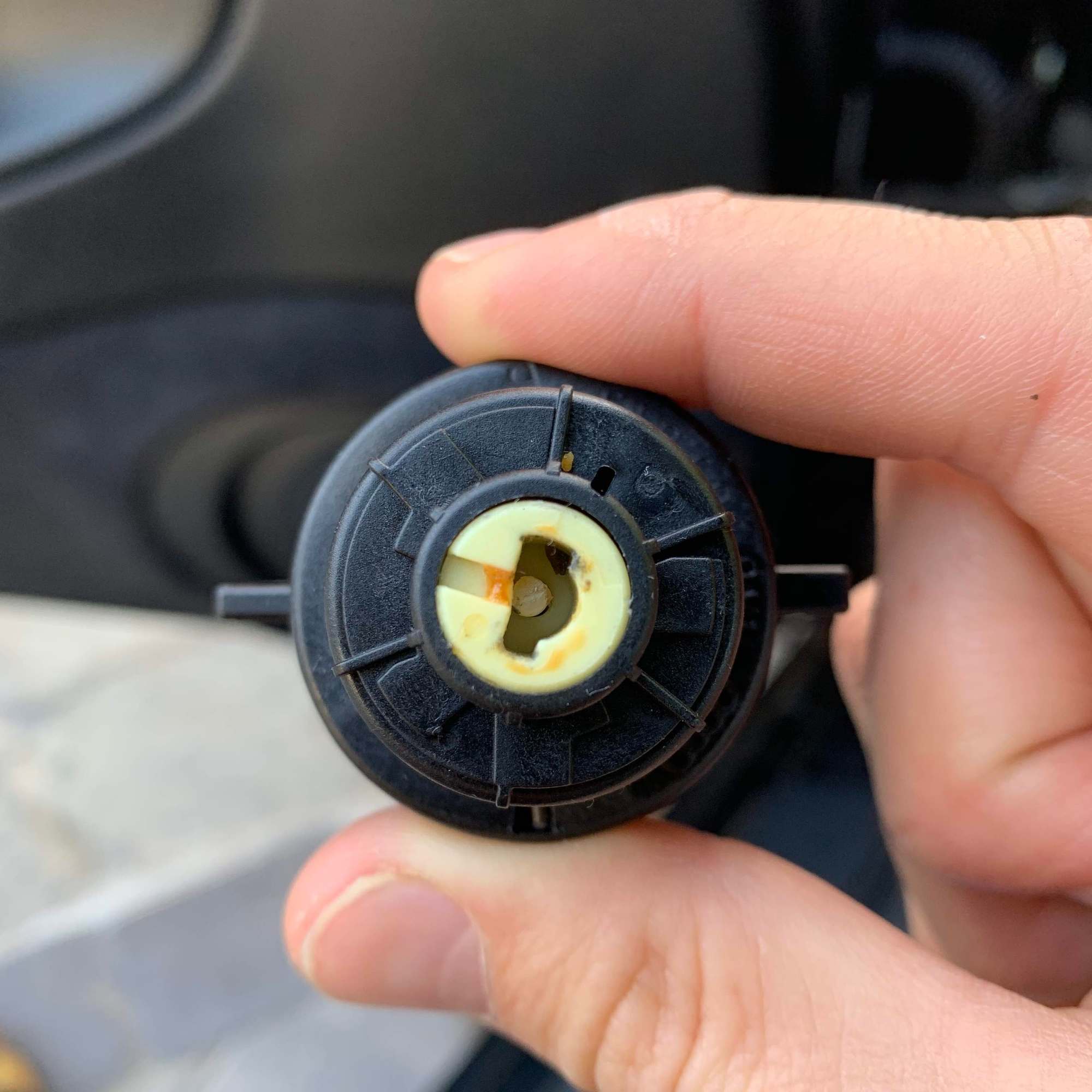

2) I removed the new ignition switch. This time I ensured it was in the off position. I don't know if it was in the correct position when I first installed it. But at the end of the switch that goes in first (mine is yellow) is where the end of the key gets inserted. I figured that if the key goes in the 0 position then this switch should also be set to that position. So I turned yellow slot to the 0 position with a flat head screwdriver.
3) I reinstalled it and presto, the car starts perfectly.
4) I have no idea if item 2 above was the issue because I'm not really sure if the key could have been inserted if the yellow slot was in the wrong initial position. Nonetheless, if you are installing a new switch make sure it's in position 0 before doing so.

Hi, I got exactly the same problem today. After replacing the ignition switch - the key would rotate smoothly but the car won't start.
I figured, the problem is in yellow "key hole" position in the back of ignition switch. if it doesn't stay precisely where it has to be, the car won't start. In my case I turned it about 1/16" counterclockwise and it worked. I've read somewhere it's gotta stay on 0 position, but I couldn't find anywhere to show where exactly that position is. Also there are no markings on plastic anywhere...
Good luck.
