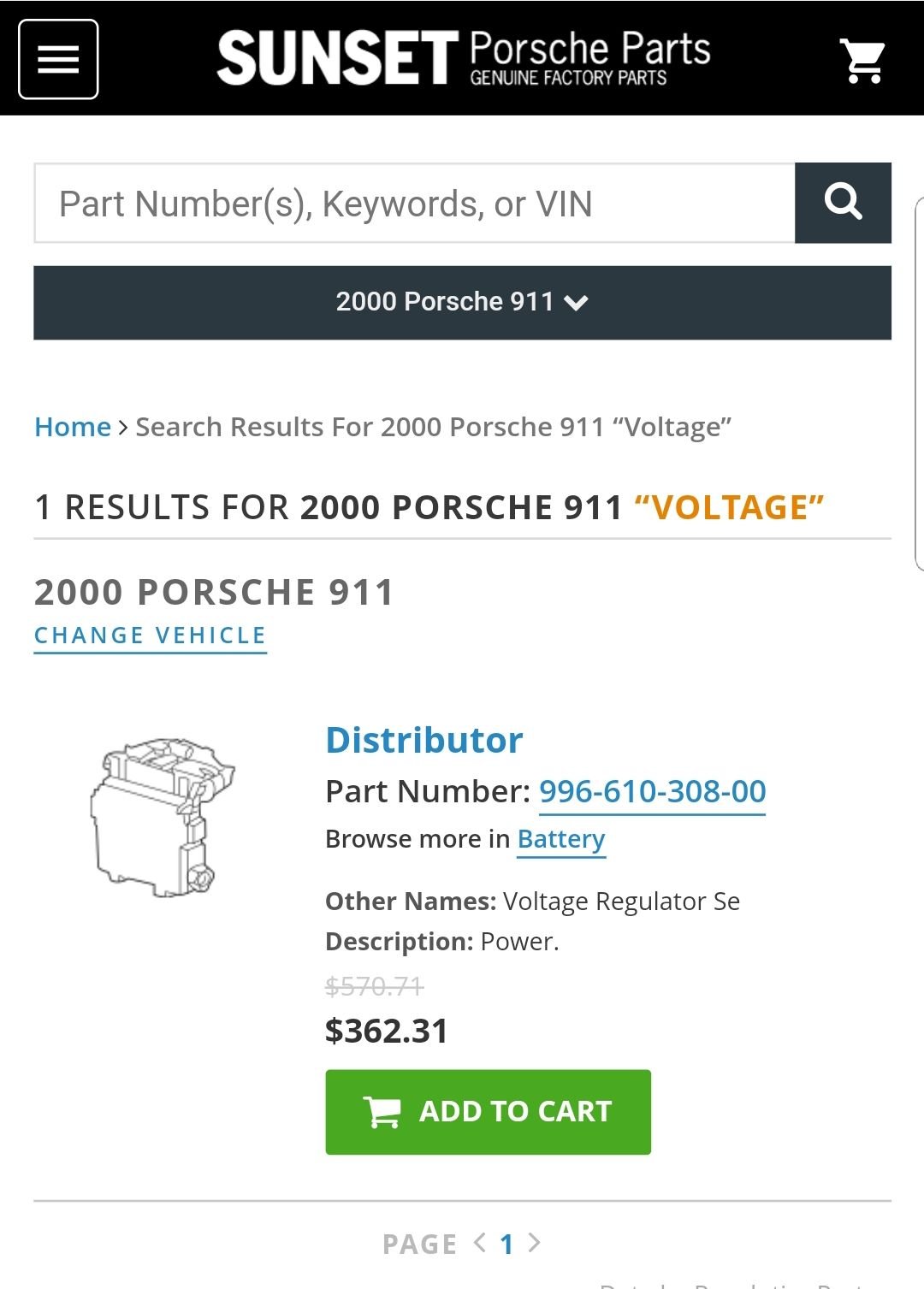

so the voltage regulator. Which is correct?
only item I found on sunset porsche in terms of voltage regulator
And this on pelican parts.
Old Jul 27, 2018 | 10:36 AM
ZuffenZeus's Avatar
Joined: Apr 2018
Posts: 212
From: Athens GA Area
ZuffenZeus is infamous around these parts
That's a good question. I looked up the number for the first item (99661030800) with Porsche Parts of Atlanta and it shows a complete "distributor repair kit" and so I'm assuming it includes a few known wear parts in addition to the regulator? The other two, IMHO, are the basically the same part with Porsche rebranding it as OEM. That's my opinion. But I wouldn't know if there is something unique between the two parts.

#16 is the kit (99661030800).
it also looks like one is at the battery (sunset) and the other at the alternator (pelican).
