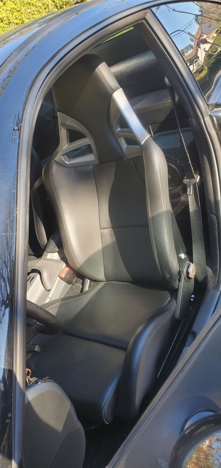

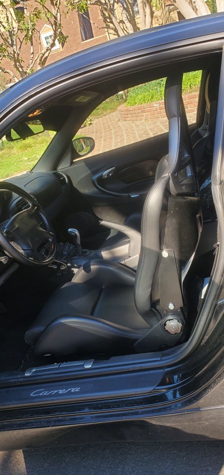

Here are some pics of the seats in the car. The upholster did a fantastic job.

Those are beautiful seats, including real custom leather! Have your resolved the squeaking and stability issue to your satisfaction? Where did you get the bit to tighten them up? Are they able to tilt forward for rear access on command like the stock seats? Guys on the 911UK are pretty happy about their GT3 knockoffs (fixed back) once they have custom leather added.
Old Jan 26, 2022 | 07:19 PM
nottoshabi's Avatar
Joined: Apr 2012
Posts: 211
From: Sherman Oaks
nottoshabi is infamous around these parts
A: No. But with the radio going I dont them. When talking to some one in the car then they are annoying.
A: Can you elaborate on this more I dont know what your talking about.
A: Yes.
I can not express enough the satisfaction of the leather, you get a real pungent kick of leather when getting into the car.
