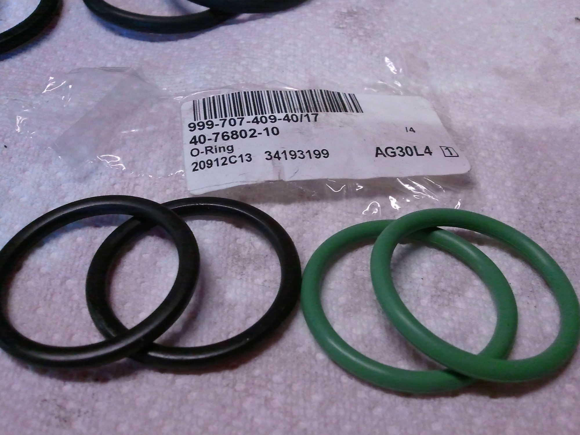

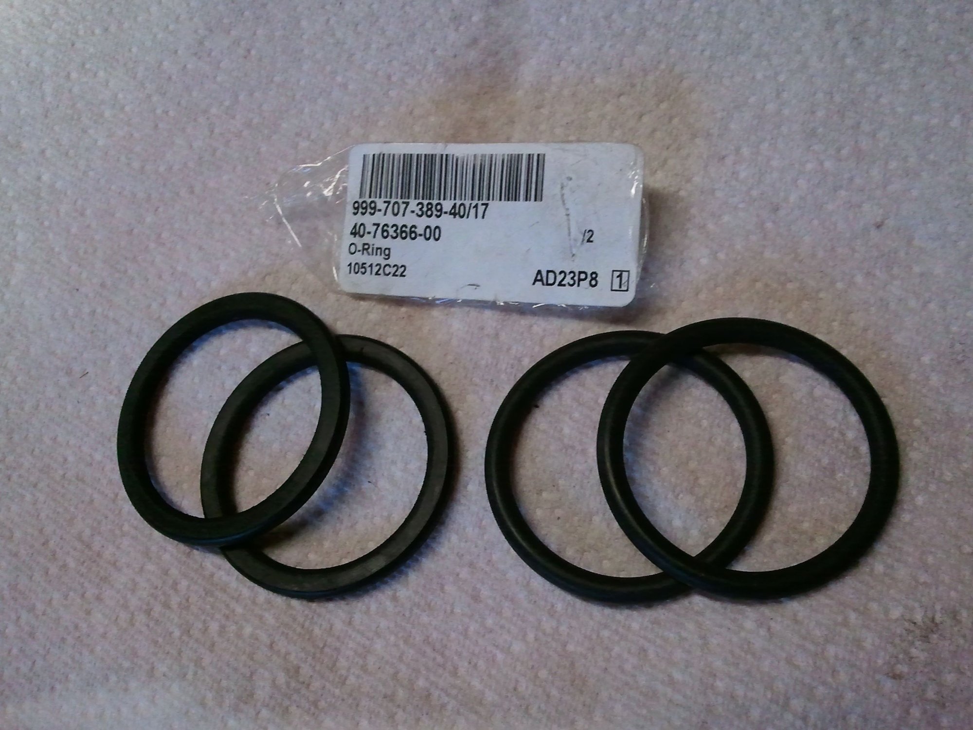

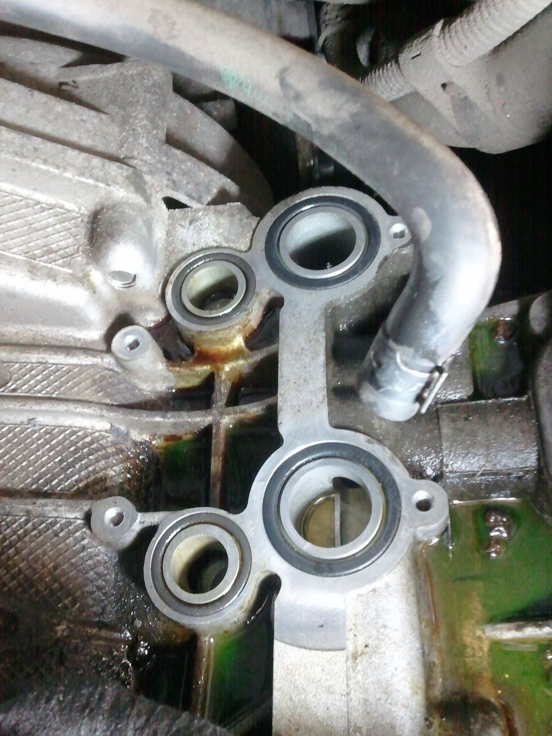

On my 99 c4 this was the seals between the oil cooler and the block. I also had some antifreeze showing in the same area.
I drained the oil and coolant, put a shop vac on the expansion tank to pull some vacuum (it is an oil to water cooler :-)). On my block the seals where 2 different sizes. I managed to avoid any cross contamination somehow
120,000 miles later and still tight and dry
This was in Nov 2012 so what I remember is vague, except for how cold it was :-(
