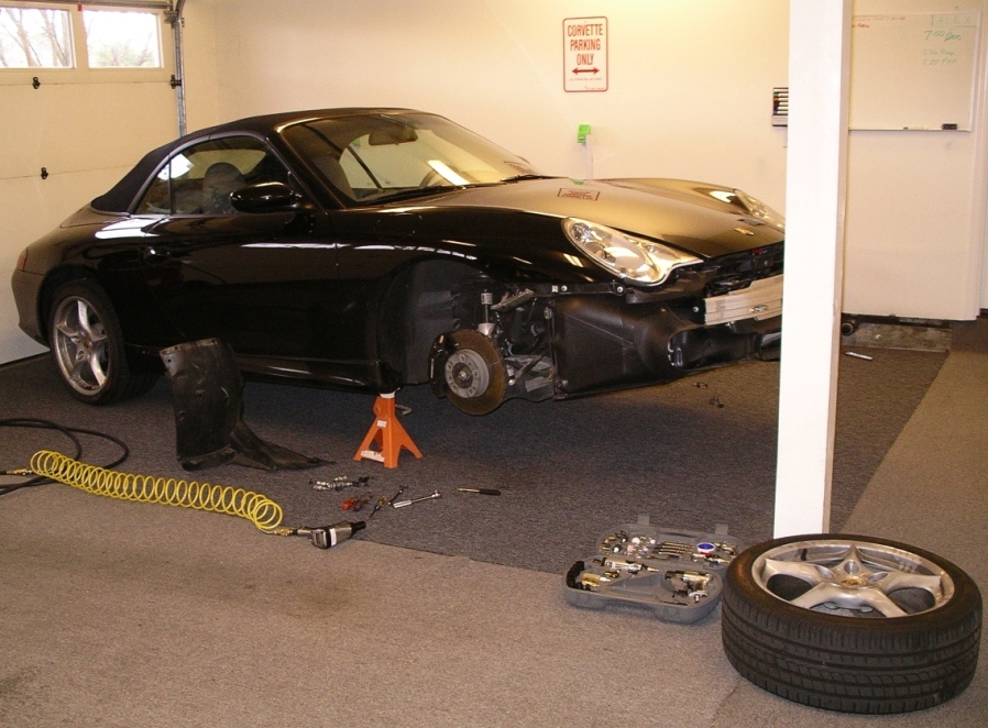

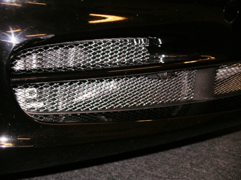

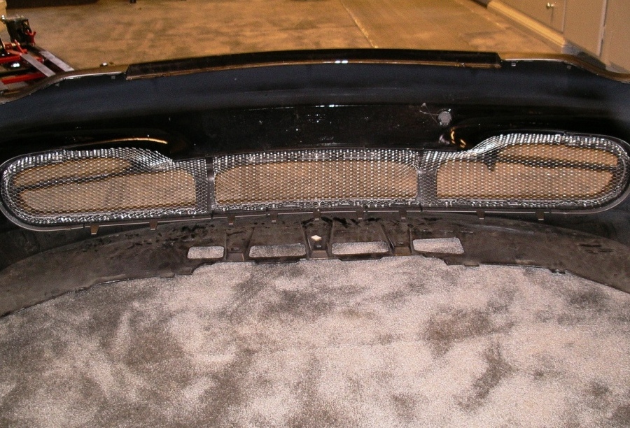

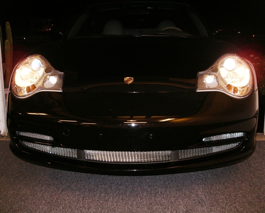

Hi, I removed my bumped two weeks ago to install mesh in the Air Dam. I used the Renntech instructions and it was a piece of cake. See Attached photos.

How long did the removal of the bumper alone take? Are there special tools that i need other than the regular household tool box tools? i am thinking of just dropping off the front bumper to the body shop instead of leaving the entire car with them for a week. thx
Hi,
It took about 20 minutes to get the car on jack stands and the wheels off. My floor jack does not fit under the back of the car. So first it I needed to raise the car from the front lift point, then put a small brick under the front tire. Then let the car back down on the brick. Then I could get the jack under the rear lift point. The front of the car will come up high enough to get the jack stand under the front lift point by lifting it from the back lift point. Then repeat on the other side.It took another 30 minutes to take off the bumper. I could probably get it off in less than 20 minutes the next time. I also have air tools, so that saves some time.
Tools:
jack, jack stands, 19 mm socket for the wheel bolts, phillips and flat blade screwdrivers, Torx bits T25 & T30, Torgue wrench for wheel bolts.

I didn't remove the wheels. I just rotated them to access the plastic pop rivets and metal screws. There are 3 philip screws around the side markers. 1 is behind wheel liner.
Take a mental note of how the bottom cover attaches to the plastic panels / wheel liner.
It took me a couple of hours to get it off. Surprisingly, putting it back on was easier since I know where the screws went.
