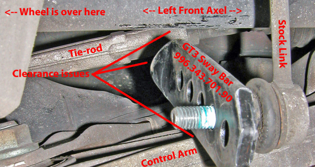

Is there anyone out there that has already made this this modification?
I'm in the process of installing GT3 swaybars on my 2000 6sp coupe C4. The attached photo shows how I have the front bar positioned right now; between the axel and control arm. Does this look right?
When I position the bar over the top of the axel it gets dangerously close (~1/8 inch) to the tie-rod with the wheels pointed straight ahead and I don't think it will clear at all when steering left or right.
Surprisingly the stock link seems to fit well as adjusted here. I have a set of adjustable links on-hand, but with the bar as shown they are way too short.
Any insight or advice would be appreciated. Thanks.

The GT3 bars on a 996 is NOT a direct bolt on...you need the appropriate drop links....TRG (The Racers Group) sells a kit to put the GT3 bars on a 996 ith adjustable drop links. I think the rears will fit on one setting with teh stock setup, so you lose the adjustability unless you get the custom drop links. T my knowledge the front bar will not work at all without adjustable drop links.

You need a curved front link - availablle through us..
You will need to get a adjustable rear link- We can modify your existing ones to work......

the curved one's work great. i have the TRG versions (on the left) and they have been awesome. great range of motion with no binding.
